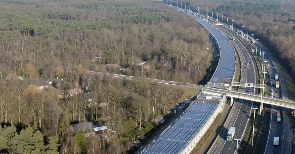

          The roof of a two mile stretch of tunnel over Belgium's high speed rail line has been fitted out with 16,000 solar panels to provide power for trains running through Antwerp Central Station and the surrounding railway infrastructure. Solar solution provider Enfinity says that about 4,000 trains per…

            http://www.gizmag.com/solar-rail-tun...mpleted/18881/
            Another wacko idea with government money carrying the day. All this is silly green BS. The cost of the land is not that big of a deal.
            Not one of those 245 watt panels is oriented in an optimal direction - they are far less than what they should be - cleaning is a really big deal.
            The advertising is eye candy for the green fools to support.
            All in all, really a stupid idea.
              For the Gizmag thing - Say 50,000 m2 of panels operating at 10% efficiency (which is very high considering orientation) for an average of 3 sun hours per day (it is Belgium and that may be excessive) 365 days a year = 50,000*.1*3*365/1,000 = 5,475 mW generated. Maybe 150,000$ to 300,000$ US worth of power generated per year - for that investment wow NOT

                The real issue here is cost. There are lots of cheaper places to put solar arrays than over roads.
                Consider that a solar array over a road needs to be elevated above the traffic on a structure strong enough to withstand windstorms, snow, etc., and in a way that it won't cost huge amounts of money to fix every time someone crashes into a pole, and you begin to appreciate the challenges. That solar railroad, for example, cost about $5/watt according to the article you linked, which is substantially more expensive per watt than putting the same number of panels on the roof of a warehouse.
                Maybe once all the suitable flat roofs, parking lots, billboards, etc., have been covered in solar panels, then roads would be worth considering.

                  That 5$ per watt is just a number some fool at Gizmag pulled out of his backside (or some Belgian did). I quit Gizmag long back due to their loony reporting.
