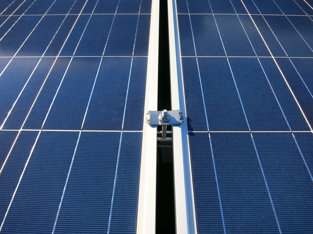

Now back to the panels above the gutter from yesterday...
Not only were they above the gutter, but they didn't install the mid-clamps correctly.
These are supposed to go vertically, not horizontally, so that the sharp ends puncture through the anodized coating and ground the panel, like this...
So with that, we redid all of them, put the clamps the correct way, moved them up and all looks great now.
