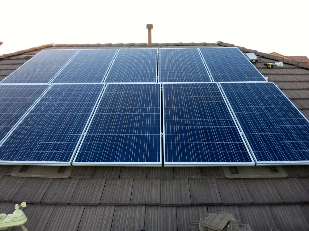

Can you believe it, we have panels up! They still managed some sloppiness but it can be fixed, I was up there most of the day but couldn't be there every minute supervising.

Now some of that sloppiness I was talking about, and maybe it's just me being way to anal, I don't know.
First the spacing left between rows of panels. All other installs I've seem the panels butt up against east other...but thinking about it maybe it's not so bad, better ventilation for the panels and it seams some walking access if a panel needs servicing.
This one though I caught and made them use the right claps. For some reason, they were using black end clamps, but silver mid clamps...and of course silver rails with silver frame panels. I mean really, you couldn't use silver end clamps too? I had actually ordered a bunch of silver ones and had them ready so they used the ones I had.
Next problem, panels were mounted too low and therefor the gutter is now useless in the courtyard.
Not just that, but the put the rails in uneven (top rail uses the bottom mount holes, bottom rail uses the bottom mount holes) which makes the panels not line up. Probably being too anal here but would it have been that hard to just do it right?
And finally again the lining up...would it have killed them to mount everything lined up instead of zig zag like this?

I guess there isn't a stand-off requirement between panels and roof edges where you live?LG280/SE6000/[url]http://tinyurl.com/pav2bn8[/url]Comment
Mine are 4 rows of 11 panels per row mounted in portrait mode and there were no gaps anywhere at all. Looks like 1 seamless piece.
Knowing you, I bet you're going to go back up there and move the panels around a little bit to get them all lined up with no gaps. Otherwise it's going to gnaw you up until you go crazy. You've gone this far, might as well put in the final effort to make it look as perfect as possible.Comment
LOL...I don't know, like I said while it would look better to be seamless, I can see some benefits to having a walking path if a panel needs replaced or when I wash them.Mine are 4 rows of 11 panels mounted in portrait mode and there were no gaps anywhere at all. Looks like 1 seamless piece.
As for why they left a gap, pretty sure it was a mistake. They started with the bottom row and just mounted where they thought was good, without taking into consideration how the panel above it would fit in with it.Comment
