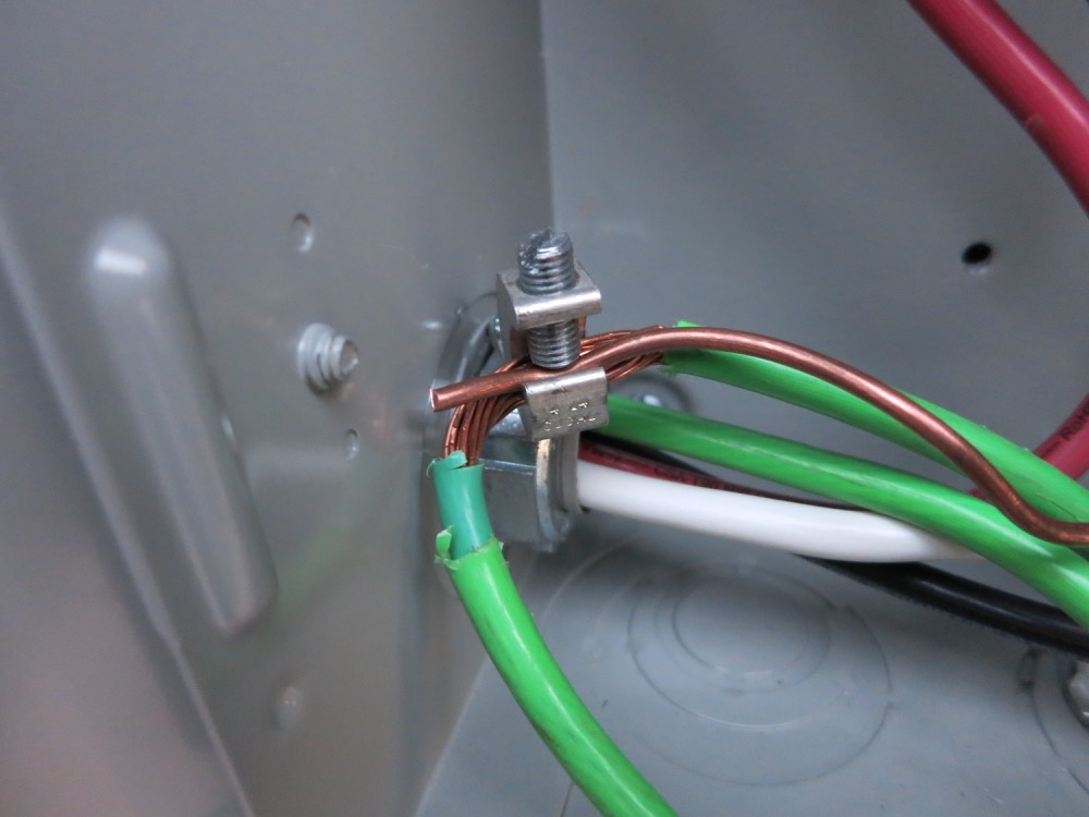

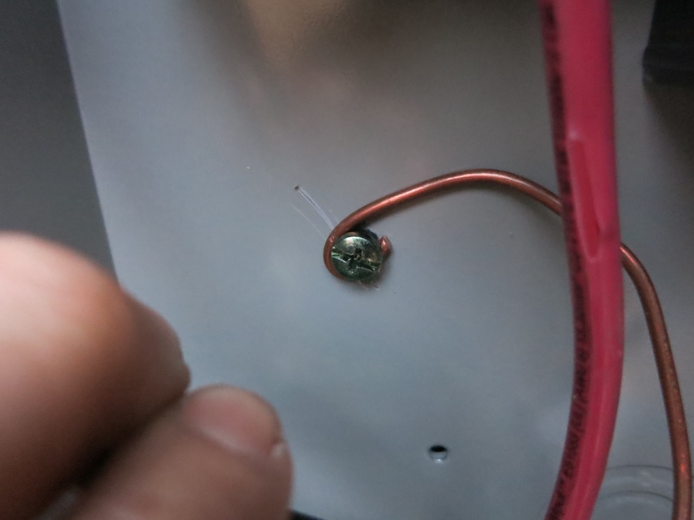

                      Worked on tidying up and fixing a couple things today...
                      First I took care of the ungrounded disconnect box, hopefully I did this properly. Used a 8AWG bare copper wire, scratched off a bit of the paint inside for a good bond, and used the same grounding lug. It looks good to me, but I have no experience with this.
                      Then I worked on running the CAT5 cable from about a 10' distance away from the inverter, to the inverter.
                      I got lucky here in the sense that the house already had a cable running to this location from the networking box inside the house, just had to crimp on a connector on this end and plug into the networking switch in the other end.
                      Cleaned up the rat's nest of conduit as best I could by moving the irrigation control box.
                      I'm definitely glad I insisted on the installer re-running the metal conduit down and under the fence instead of the crap he originally did, looks a lot cleaner.
                      Now just have to paint everything the color of the house and it's all done.
