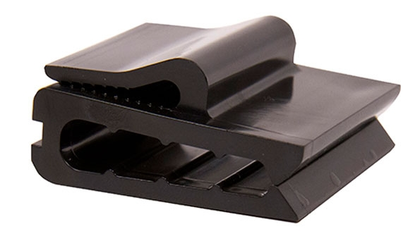

      I saw this ad yesterday showing a clip to keep PV wires secured.
        • 15124
        Originally posted by GreenCodeInspector
        Again, thanks to everyone. There's some good things on the web about wire management of PV installations, but the code is a little scant. There are some developed lines of interpretation that require all PV wires be carefully bundled, which is certainly what I like to see. In any case, it's true that they have to be secured/supported at certain intervals, but single-conductors fall in a weird category, since of course they are generally not allowed at all, so they aren't documented as well as all the cable types, for example.
        I tried to add a link for a new type of cable clip that retains the PV wire being run from and under the panels.
        Since the link was not approved I will just state that you can check out the article at Electrical Wholesaling. The clips are called "Ty-Rap High Performance Cable Edge Clips" made by T&B which are sized for the #10 awg PV cables and come in a few different orientations.
