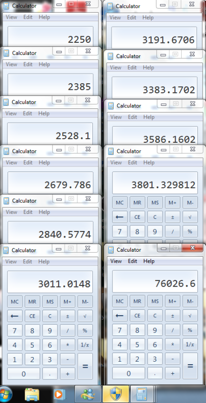

                              Not really here's the break down. Cost in PV atleast for chinese PV, makes off grid solar lower than GRID Parody. I've done the research. Without inflation,this is the calculated cost that a californian with an 1130sq/ft home pays. I calculated the first 10 years so the 10th year becomes average annual cost for 20 years, basic averaging.
                              That last calculation to your bottom right is what I would pay over the course of 20 years. $76,026.50 is assumed, this is without inflation whihc as national debt grows so does the cost of a dollar. So what is $76,026.50 now will look like $78,307.30 is is assumed inflation in 20 years rises 3%.
                              I can purchase all components with tax included (I will round up) $63,000. Now if I was to use high efficiency panels such as sunpower, or schott which are around $1000 per panel pre tax I'm looking at upwards cost of $92,000 system cost assumed. Cost of suntech PV $490 per panel after tax. sunpower or schott $1100 per panel after tax per panel.

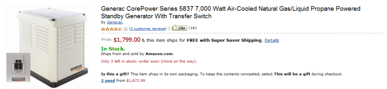

                              Now don't get me wrong. I have considered grid tied with a back up generator. So when grid goes down my solar would still make power.
