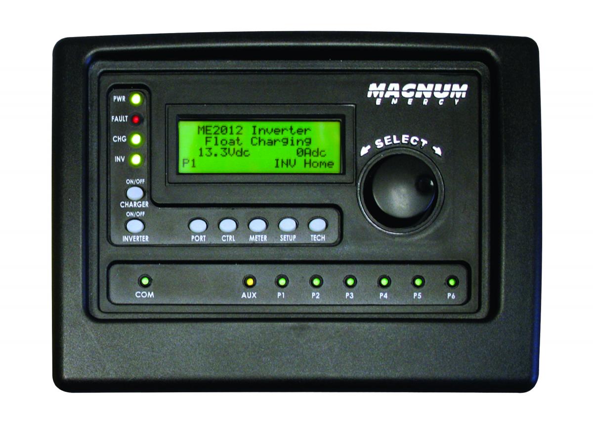

There is 1 Magnum remote controllerSo do you ,in fact, have 6000 watts of solar panels charging a 24 volt battery through one 60 amp charge controller? That doesn't sound possible as you have a potential 214 + amps available If it is in fact that's what you have, your controller is limiting your charging output to a mere 60 amps.
And 2 Magnum power track performance charge controllers

Which is why I called Magnum and spent 2 hours with their customer support. I wanted to understand the auto-start better and what could be the issue.
We went thru every setting on the controller and also some of the solar charging hardware.
(1) they were the first person Ive spoken too to NOT dismiss my claims of the system not performing immediately after the auto-start was installed. They were very perplexed at the coincidence of it all.
(2) that said, they could not fathom how the auto start would have any effect on voltage readings. So that sorta scratched out the "shared responsibility components" theory.
(3) so then this is when it got "fun". We went thru all the settings on the controller and here are the mistakes found (some of which you already alluded too)...
- AGS stop was set to 28.8 (shouldve been set to FLOAT)
- Absorb was only set to 2.0 hours (shouldve been to 4.0 hours)
- and here's the REALLY big one, the BMK was set to 790aHrs (so the controller this entire time has been charging for a smaller battery bank than was already here and for too short a absorb time)
- and lastly, the jumpers on the solar charger controllers were set wrong, and were set for a much smaller solar array than I currently have
So yes, the batteries have been taking a beating. During the summer due to the jumper settings and since November when the generator was being used heavily since the absorb as set wrong. And apparently the entire time since the BMK has been wrong all along. Magnum had some settings and charging advice that they thought could try to salvage the batteries a bit but cleaning off the plates (forced charging) and so Im going to try it.
This is mostly a installer setup error, and the resulting damage to the batteries not being charged fully.
