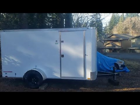

6x12 cargo trailer conversion for camping.

                          Well I bit the bullet as they say, and bought the solar panels. painful on the wallet, but this way I can be sure they all match. Final bill was $1,034.49 after tax. Shipping is free. so about $1.04 per Watt. As far as I can tell, that's pretty good for smaller panels.
                          I've been running my old mini fridge for almost a day from the battery and inverter. The battery voltage has barely moved. It may be a couple days before the battery gets low enough to test the charge controller again. I figure that's a good problem to have.
                          I've made the first video of my series for this project. It's not much; just an introduction. But if anyone is really bored, you can watch it:
