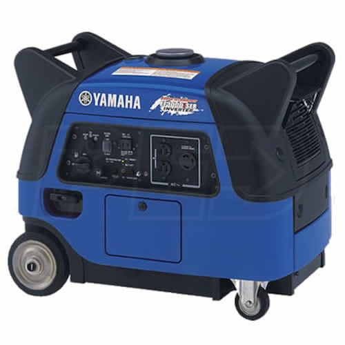

I have read on other boards that folks have used the Yamaha equivalent (or a larger Honda). Some of the Yamaha models have a small battery booster pack which enables much higher starting currents specifically for air conditioners, air compressors, and other high inrush current power tools.
Such as the Yamaha EF3000iSEB for example. Of course these are larger and pretty expensive.

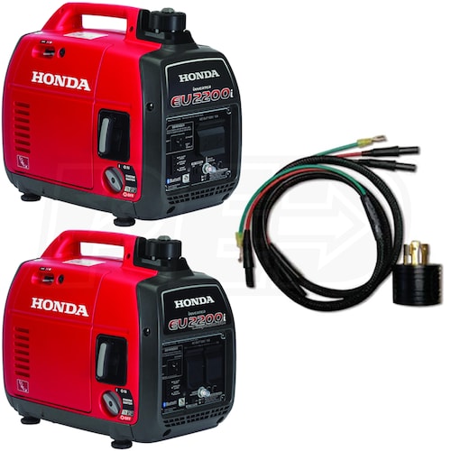

If you already have an EU2200i you can potentially parallel it with a second one. For ~4400W peak, 3600 continuous in theory. Total price for the pair is less than the Yamaha with boost.
https://www.electricgeneratorsdirect...or/p82267.html
Might be a more flexible if somewhat cobbled together solution. You could buy one, see if it works, and then add the second, if not.
