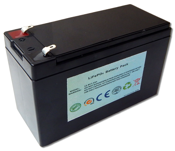

    Would the BMS be sophisticated enough to test if a load has been connected?
    Very doubtful. LVD's just monitors cell or pack voltages, not current.
    Originally posted by Dave C
    Would the presence of a load affect whether or not the battery disconnects?
    It should. The controller needs a load, some current flowing to maintain controlled voltage regulation
    What kind of load would you recommend connecting to the battery terminals? What kinds of complications would that introduce?
    Any load. It does come with a catch. It drains the battery. All your issues revolve around a battery with a HVC circuit disconnecting the charger. How do I know you have HVC and LVD? Because your battery says it does. In your case the term PCM = Protection Circuit Module. . Here is another battery similar to yours, a 4S 6.6 AH with two ports, a charge port and discharge port with PCM. Sound familiar?
    What battery would you recommend?
    One without a HVC circuit. Your battery module has a HVC as part of the PCM. It is unnecessary automation which causes more problems than it is worth in my opinion. It makes it incompatible with Solar. I assume you want something modular in a box right? Something on the lines of a Power Stream 12 volt 7 AH LiFe battery. They are drop in replacements for AGM batteries in Alarm Systems. It has a crude BMS with balance boards and LVD. However no HVC and will work just like a regular battery. It can be charged as high as 1C and discharged at 2C continuous. It will work with any solar charge controller or battery charger made for lead acid. Ideally you want a CC/CV charger set to 13.8 to
    14.6 volts. Just what the Doctor ordered.

                          I'm waiting for Bioenno's answers to 2 questions: 1) under what conditions will the battery reconnect after it has disconnected due to high charging voltage; and 2) what's the max voltage the BMS can handle.
                            #73
                            Okay, let me see if I understand what you're saying. The GV-5 should never have allowed the battery to reach 14.6V. It should have backed down current to the battery's leakage current (200mA, I thnk) once it reached 14.2V, thus preventing the voltage from drifting upwards any further. But because it's a "leaky tap" it allowed higher current to pass, thus causing the battery voltage to reach the high charging voltage disconnect point. Is that what you're saying?.
                            No that is not how it works. Understand the difference between an Open Circuit, and a Load. No MPPT Controller can modulate 0%. To do that takes more circuitry and expense. A Controller is designed to have a battery connected at all times (load) and not be disconnected (open circuit).
                            MPPT controllers have large filter capacitors on the output. That capacitor is to hold a charge in between on/off times of the controller. During the off time, the capacitor discharges into the load or battery. If you open the circuit, there is no place for the capacitor to discharge. The fact that no controller can completely shut off or go to 0% modulation it keeps pumping some energy into the capacitor keeping it fully charged up because it has no place to go.
                            The issue is your battery has a PCM aka Protection Circuit Module as you noted. The two ports, one for charge, and the other for discharge tells you the battery has a HVC circuit to disconnect from the charger when fully charged up. Your battery is simply not compatible with solar charge controllers.
                            As for the GV5 it will work, but you have to put up with nuisance High Voltage alarm. The GV5 gets its power from the solar panel where others get their power from the battery. A possible work around is to keep a gizmo connected to the battery load port. So when the battery reaches full charge, the gizmo load shunts enough power to keep the battery connected to the GV5 which will maintain 14.2 volts and FLOAT the battery.
                            The issue again is your battery and its PCM, not the controller. Best solution is to get a standard 12 volt Lithium battery as I linked too earlier. Something like this one. Stay away from batteries with a PCM and two ports. Click this link to see what is available. Take note some are PCM, stay away from them.
