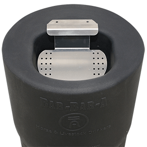

                            Here is the ultimate low energy freeze proof sheep waterer.....in fact it uses no energy........
                            I've used this waterer for my sheep for over 10 years and never failed.
                            • DanS26
                              • Dec 2011
                              • 1001
                              Mike......Google "BAR-BAR-A Sheep / Goats Automatic Waterer"
