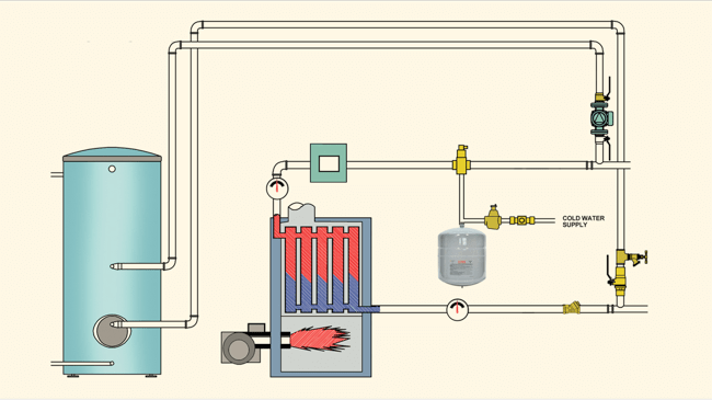

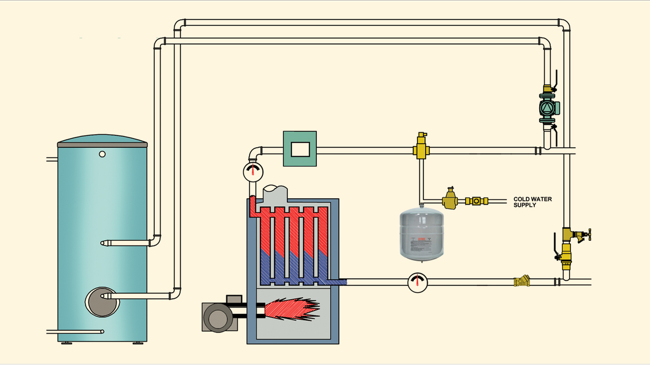

                When water is heated, it expands, increasing the pressure in closed heating systems. An expansion tank is designed to alleviate the pressure and extend the life of your system. Here's how it works.
