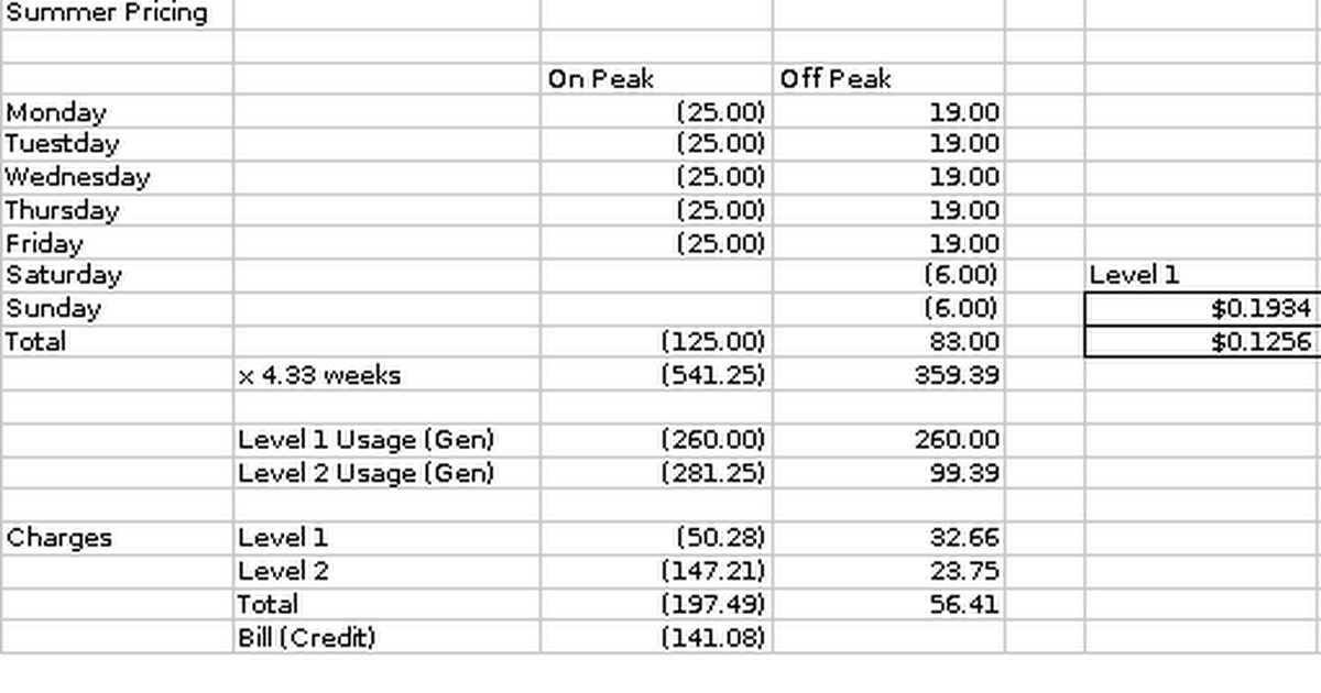

I just switched to TOU-DT using SCE. My smart meter was installed about a month ago but my hourly usage tracking just went live a few days ago. As such what I'm stating here is what I understand it to be, but I have no real-world TOU billing experience so far.
Quick background - I had the system installed in March 2011 and it generated about 10,300 kWh for the year. This offset almost all of my usage for the year and I was at a surplus for most of spring/summer. I got a rude awakening when I realized that the credits I got on a monthly basis were the tier 1 rate (or something similarly miniscule) multiplied by my surplus for that specific month - usually something like $10.00. In the winter months when I didn't generate much I got into Tier 4 territory and paid that fare and had back to back bills in excess of $200 each (lower than my bills pre solar, but still more than I wanted to pay). I know life isn't fair, but it seemed like BS that I'm getting paid $0.05 when they really need my electricity in the height of summer and then charge me $.25 when I use it at night in the winter to heat and light up my house.
Because I couldn't roll my summer generation into credits for the winter I decided to explore TOU since I perceive that will effectively do that, and here is why. I believe that TOU Level 1 / Level 2 apply both for the generation and the usage. I don't recall what level 1 is, but I think it's something like 260kwh. Assuming that is right, if you generated under 260kwh during peak hours in the summer you would get paid $.1934 for each kwh. However if you generated anything above 260kwh you would get paid the $.5234. Because of this the credits can theoretically be larger in the summer, and those can be used to offset the higher winter bills.
Yesterday (the 14th) I generated 25.6kwh during the peak hours and used 19 off peak. I created a quick spreadsheet that shows how I think it could play out if each and every day were the same. Recognizing I don't think "Summer" has started yet, I used the summer pricing. You need to remember that Sat/Sun are off peak, so that daytime generation that is usually during peak hours is actually off peak. My 4.33 multiplier was trying to take the weekly and convert to monthly. I also took a quick guess at Winter usage with those rates rounded to the nearest cent (I only jotted them down once). Clearly in the height of summer we'll probably use the AC more, and in the dead of winter perhaps more heat, but here is my guess at how the bill could work. It's late now and I need to get to bed, so it's possible this version has a major error I didn't see yet. If anything jumps out at you (or anybody else viewing it) let me know.
DerekLeave a comment:
