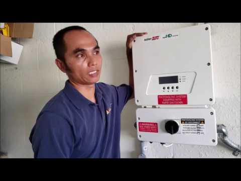

Video of Ethernet Install/Setup:

From the video you posted above, I really do wish I'll end up with the inverter with the display. It's great to be able to configure it and see stats right on the unit itself. If I do end up getting the screened version, I'll likely have it in the garage, and if possible everything else (revenue meter, etc) outside.https://pvoutput.org/list.jsp?sid=69875Comment
