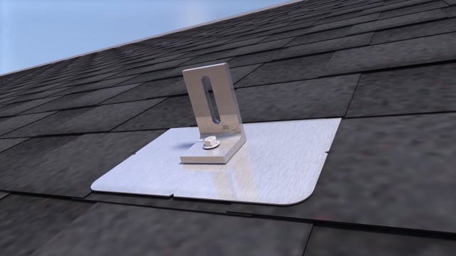

Correct, GPE spec'd my (and I'm sure sunpoweredev the same) system using Quick Mount PV's L-Mount Flashing Foot which are 9" x 12" aluminum. As it was explained to me the installers also apply gue to the underside of the flashing panel before laying it down as an extra failsafe so 1 hole or 10 I don't see water working its way back under the flashing AND glue on top of being already protected from direct driving rain do to the panel above it.
If the installers are even ~10% competent they're using flashfeet. The flashing is ~12" wide so even if they miss the rafter by a few inches and have to drill another hole all the holes are covered. You could probably cut a hole under the flashing and it still wouldn't leak. The bolt penetration is raised AND sealed. The solar anchor may actually be LESS likely to leak than the rest of the roof since it's somewhat reinforced.
I've mounted >300 solar feet... no leaks. Several extra holes...
FWIW, one thing of many I learned while watching (mostly from the ground) the ~ 130+ arrays that have so far been installed in my HOA is how many holes get drilled in roofs that seem to go "thump" about 3-5 seconds after the drill starts, with another hole immediately drilled and located in a place that appears to be immediately adjacent to the hole just drilled. If folks knew how much daylight and empty space is being created in their roof deck, or its longer term consequences, they might be concerned. I always suggest that my neighbors sit on their roofs, out of the way during installs and watch, and then bitch when they see what goes on (or doesn't go on) during an install. Of course no one does. Of all those installs, there's probably ~ 100 roofs with ticking leak problems.

Not a good feeling hearing them drilling all over the new roof.
I hear you about the roof knowing they'll likely be adding about 100 penetrations between the racking and wire runs, but fingers crossed and faith in a careful, competent and accurate install.
I'm going to try and spot check my attic today actually, because if they are any faults with my new roof this rain in the past two days should surely show it by now.Leave a comment:
Yeah, because 100 out of 130 have leaks?! Wow. I took a peek up in the attic and it was complete darkness. Good sign perhaps
