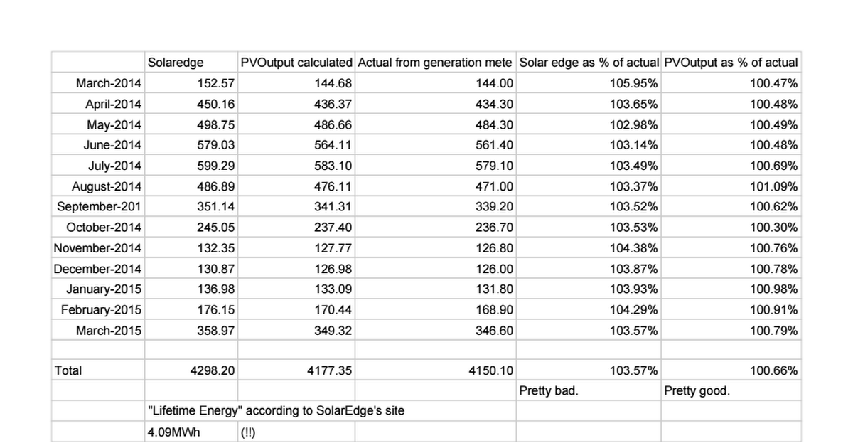

    SolarEdge POWER Accuracy? 11,900 AC Watts from 12,000 DC array
    During Array Test.
    SolarEdge:
    AC POWER generation up to 11,900 watts
    Panel DC Rating 12,000 watts (40xLG300)
    Inverter rating 11,400 Watts AC Nominal (12,000 Max)
    I thought this number looked too good and remembered that others had questioned the numbers from SolarEdge. Went back and dug up the following:
    James_King and Sensij had been looking into ENERGY generation accuracy for SolarEdge
    Results SolarEdge energy generation up to 5% high
    Then I looked at the WattVision data. It too was showing 11,900 watts. And I would tend to believe the WattVision data as it comes directly from my SDGE meter via Rainforest Eagle
    I'm fairly convinced that the 11,900 watts is real.
    Originally when I read that Sensij and others were saying that SolarEdge was reporting high that this applied to all aspects (Power, Energy...). But after rereading I see that the focus was on energy generation numbers.
    Do forum members believe that the POWER (vs. ENERGY) numbers from SolarEdge are inaccurate?
    I believe the SolarEdge power data to be much more accurate than the energy data. You can see in this post an example of both compared to revenue grade data.
    Yesterday, my array sustained production at over 90% kWp/kW, a new high, with peaks over 93%. Peaks of over 96% kWp/kW were observed in the even cooler weather over a week ago. Cloud effect, cool temps, and sun position create the opportunity for some very high spikes this time of year; several systems in Team San Diego had peaks into the mid 90's. With the optimized orientation and better cooling of your ground mounted array, I would expect that your system will outperform mine (and nearly all others) in most conditions.

      I believe the SolarEdge power data to be much more accurate than the energy data. You can see in this post an example of both compared to revenue grade data...

          The spikes in generation are real. As you suspect, the spikes in consumption are due to mismatches in synchonization between SolarEdge and the Eagle. This is partially due to the fact that SolarEdge uses a forward averaging scheme... data at 11:00 represent the average of 11:00, 11:01, 11:02, 11:03, 11:04. The data from Wattvision (or the Eagle directly, if you go that way) would be a 5 min average from 10:58, 10:59, 11:00, 11:01, and 11:02.
          Solving this is hard.... even if you could offset the averages so they are looking at the same time, the power sampling is still not likely to line up well enough to make a smooth chart. A better approach would be to use energy counters such that for each period, Avg Power = (kWh end - kWh beginning) / time. Unfortunately, the Eagle does not report energy on a predictable interval, and SE energy is inaccurate (the subject of the thread). I've been working on how to do this with an external meter, but haven't really got it figured out yet.
          The Eagle side of things could be helped by some programming that continuously sums the 7.5 s power readings... this should end up close to the true energy metered. Neither Rainforest Automation nor Wattvision do this now, and PVOutput is unlikely to take that on either. Definitely an opportunity for some 3rd party app development here.
          The SE side of the equation is a dead end, as far as I can tell. Without access to data more often than 5 min, and with no explanation of their averaging scheme, it will be extremely difficult to ever generate a spike free gross consumption chart using the inverter data for the generation source.
