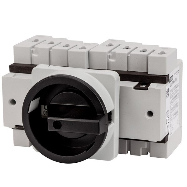

                    Searching around for different types of connectors and hardware, I found this:
                    One knob to shut down all three strings, it solves my splice problem, and I think it will make the inspector happy. He was here yesterday to insect all of the conduit/ device locations prior to pulling wire, and he was not happy that the plans didn't show a dc disconnect on the barn. It's IP66 rated, so I would just have to mount it in the right weathertight box
                    SD
                      *sigh* .... I don't know why people insist on adding more things that can fail into flames...

                        It's your choice what you install. nwdiver makes a good point that simpler is better.
                        DC disconnect can be dangerous because of stored energy in cable inductance and the arc possible when you disconnect. That switch is rated for DC disconnection and high voltage, so should be fine. It looks like it was designed for solar use. You're right that you need to find the right enclosure. If you want the switch lever accessible from outside the box, you also need the right front mounting. That may mean a large round hole or something more complex. It's tough to tell from the web page. If it is not accessible from outside the box, it may not meet the inspector's requirement.
                        I just thought of one alternative that you might not have considered for joining cables. There are low-cost crimps that will make a solid connection between cables. I recently bought a low-cost imported crimp tool with ratchet mechanism and machined hardened jaws and it works remarkably well, especially compared to the old-fashioned combination tools. Crimps are probably equal in performance and dependability to the Burndy device mentioned above, but cheaper.
                        That said, the Burndy connector is reusable, but you won't want to reuse the same wire stub. With the Burndy connector, the DC disconnect switch you found, or any screw terminal, you need to torque the bolts per specification. A Harbor Freight 1/4" torque wrench with 1/4" hex socket and screwdriver bit is fine for that.
                          And pointless. A DC disconnect at the inverter or charge controller is probably a good idea so you can de-energize your equipment but that's usually built into the inverter. I've seen ground mounts with DC disconnects mounted at the array. Why? It's not going to de-energize the array. If you need to stop current then open the disconnect at the inverter or CC. Adding to the pointlessness is if you have optimizers or rapid shutdown. 'LOL' there's solar arrays out there with like 4 different ways to shut it down.

                              Thank you for the input. I agree that having multiple points of shutoff is pointless. With the inverter based shutoff, and Tigo RSS, you can shut it down at the panel end, or the inverter end; having a disconnect mid way serves what purpose?
                              I have forwarded a bunch of info to my inspector and am waiting for a response. PITA, as he's the kind of guy that doesn't like to be told what to do, so I have to carefully choose my words. I know if I tell him the disconnect doesn't need to be there he'll want me to install three of them, just to be a dick.
