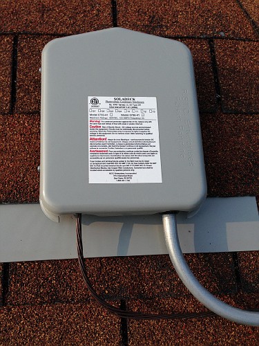

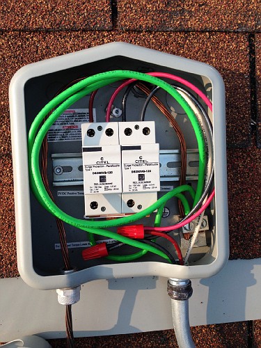

        I have the new M215 inverters with IG so no GEC requirement for me either. My array connects to its own generation meter (in WI, meters can't run backwards). Neutral/EGC for the array are bonded at this meter. For the EGC, my contractor ran #8 THHN from the meter to a lug on a soladeck rooftop junction box. This box provides all through-the-roof wiring and also houses the array's SPDs. From that soladeck grounding lug, he continued the #8 to the enphase trunk cable junction box on the array. He also ran bare copper from the soladeck ground lug to grounding lugs on each roof rack. Here's some shots of this:
