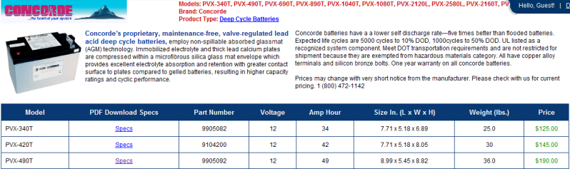

    So in comparison I was looking at the Concorde Solar System Battery. This was the specs I could pull up. 12V at 49Amper Hours. That's all I could get from that.
    Here are the claims.
    Concorde batteries have a a lower self discharge rate—five times better than flooded batteries. Expected life cycles are 5000 cycles to 10% DOD, 1000cycles to 50% DOD. UL listed as a recognized system component. Meet DOT transportation requirements and are not restricted for shipment because they are exempted from hazardous materials category. All have copper alloy terminals and silicon bronze bolts.

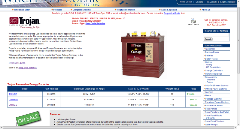

    Here is a good example you can compare side-by-side. The Trojan T-105 is a very popular battery used in just about all golf carts. Another is the L-16 for floor machines. Just a few short years ago there were not many choices for Solar Stand Alone Battery systems and the T-105 and L-16 were the default choice... Now days Trojan makes a T-105 and T-105RE, L-16, and L-16RE. Look at the specs and note the weight of the batteries. Notice the RE models are heavier?
      That was one of the main things that caught my attention the concorde is a 36 LB battery, and the optima is a 36.7LB battery. The Exterior composition of the optima is using light wieght polymers. So should I expect the DOD between the 2 batteries to be the same because of weight and composition?
      I believe I looked at a trojan 6V that I would have to run in series to get the same bang for my voltage and current.
      Total weight of 2 6volt trojan batteries 236LB.
      Optima or concorde is 36LB.s
      That is a 200LB difference
      The cost comparison is shocking though on a trojan a consumer would pay 75% more....
      12V trojan for $666.00
      12V optima concorde $170~$190

        Vinny you are not comparing Apples to Apples. It is like comparing $10 worth of quarters to a $100 bill.
        The Trojan T105 is a 220 AH battery compared to 48 AH Optima. Energy density of lead acid batteries is in the range of 40 to 50 wh/kg. So yes the Trojan is heavier because it has significantly more capacity.

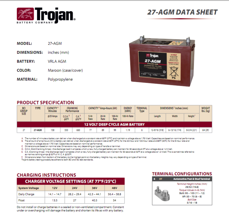

                            I haven't found any warranty specifications for the trojan AGM, if some one can find it that would be great!!

                            Total weight of 16 trojan batteries 1024LB.s, 20Lb.s pounds less than 24 optima batteries.
