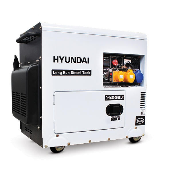

You have two AC out on the inverter, one is active only when AC in is life; use that for the immersion heater. Is in the manual. What model of Victron do you have please?
Also the bonding for the neutral to earth is done internally via relay so you can break when AC IN is active. You just need to tick the box in the settings menu.Comment
Victron Multiplus Compact 24/1600/40/230acYou have two AC out on the inverter, one is active only when AC in is life; use that for the immersion heater. Is in the manual. What model of Victron do you have please?
Only one AC in AC out. 😕
The compact series does indeed has only one AC out. In your situation you will need separate AC distribution before the inverter for the immersion heater, as you described in your first post.
When you mentioned the generator of 6kw, I assumed you got at least a 3kva multi or quattro.
How about a link to your generator ? if it has several output connectors, one can be connected via a relay, to the water heater. You never want to let the generator wind down with a Load connected. The inverter will disconnect when the freq/voltage goes out of spec, but the water heater needs to be manually disconnected or have a relay take it down.
gen: http://tinyurl.com/LMR-ListerComment
So, here's what I'd suggest.
Use a sub panel with breakers for the house and heater
Plug the sub panel into the generator, and only switch on the heater when you need it, and off before shutting down the genset
this was an interesting tidbit from the website[generator] -- Sub panel ----- house" A. Upon test, we found that they trip out at 24.955A, with the incoming comfortably running at 21.7A.
------ heater
