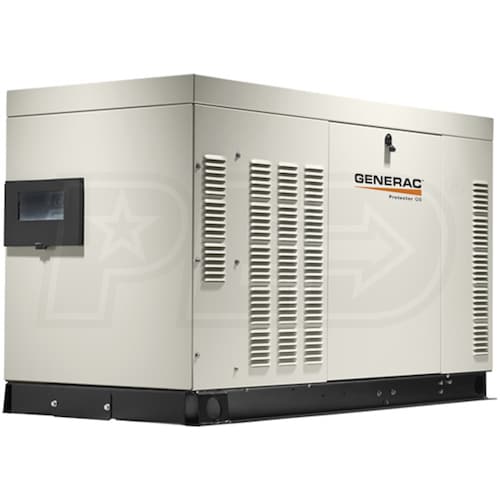

In a residential setting, you'd want to minimize the wiring cost (and the space it takes up) as much as possible. But unlike whole house natural gas generators which are cost effective and large enough (usu 10kW-22kW) to pickup the entire panel board using a simple manual or automatic transfer switch
For example this 22kW 1800-rpm natural gas unit from Generac -- $8800 -- will put out 92 amps @ 240VAC continuously
https://www.electricgeneratorsdirect...or/p15945.html
https://www.electricgeneratorsdirect...b8c980b1c8.pdf
None of the Solar PV / Storage solutions I've seen have been very large. Meaning that a lot of additional wiring would be necessary to separate out the protected vs non-protected circuits. And run times would be only a few hours -- aka good for a blip and maybe a downed pole. But not for a hurricane, ice storm, etc.
