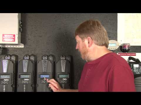

I need help with different values in menu settings - see manual map:
1. CHARGE MENU
- Advanced -> SKP (Skip) = Days ?
- Limits -> Mint-Comp = Volts ?
- Limits -> Max = Volts?
2. AUX MENU
- I need all values for Aux 1
Thank you for help.
This gives some information on the SKP function http://midniteftp.com/forum/index.ph...32365#msg32365
runs through the Charge menu. The Limits are to do with temperature compensation. This should be disabled by setting the temperature compensation to 0.0mV/degree/cell
runs through the Aux menu options.
Last edited by karrak; 05-22-2017, 08:33 AM.Off-Grid LFP(LiFePO4) system since April 2013Comment
