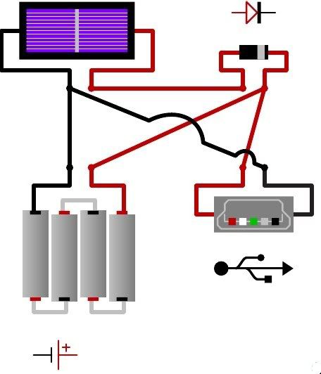

                Is possible to wire a battery pack, solar panel and USB port in such a way that it uses solar power while there's sunlight, but when there's no sunlight it pulls power from the batteries? And not charging the batteries.

                    No, I want to use solar power to listen to some music outside. When I hook the player straight up to the solar panel, I loose everything when I theres cloud coverage. So I thought that I would incorporate some AA batteries and keep them charged in the process. But after what I've learned about NiMH batteries the charging part seems to be a no go. I was wondering if a circuit could be wired where the cd player would get its power from the solar panel when there's direct sunlight, otherwise the batteries would power it. No charging batteries. It will only be used in daylight and disconnected after use.

                        Would this work for a charger? Would NiCD work better than NiMH?
                          NiCad is a little more forgiving on the overcharge than NiMh, but really, when chargeing sealed batteries, you SHOULD use a charge circuit.
                            Technically there is no difference between NiMh and NiCd. Only real difference is one is toxic, and the other is not.
                            If should work but you stand a chance of ever charging the batteries. If you are going to do this the best method is select a panel where its Imp is no more than 10% of the battery AH capacity.
                            Take note here one day you may notice when you open the battery compartment up a going stinking mess from the batteries venting expelling electrolyte. If that happens toss the whole thing in the garbage because the electrolyte is very corrosive and will destroy your gizmo. If it is NiCd the the mess will be very toxic.

                              If I am pulling a load through the USB wouldn't the batteries be just trickle charging?
