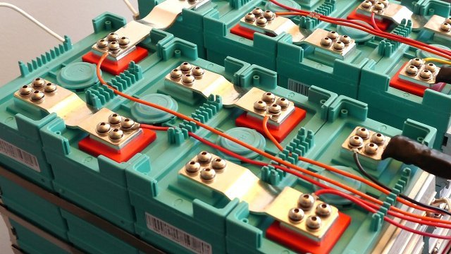

              In emergency FLA can go down to 0% SOC where Lithium is a brick at 0% SOC.
              How is any battery other than a brick at 0% SOC
              And I can heat my food at microwave with a 10% SOC LiFePO4 even if is 5x smaller capacity than a Lead Acid.
              0% SOC is for an empty but not dead battery most LiFePO4 get their stated capacity at 1C rating at around 3V/cell.
              And here is my real battery with 100Ah cells no need to connect multiple A123 20Ah cells.
              This battery is available since 2009 so already 5 years in the field used mostly in harsh automotive environment not light off-grid energy storage.
              This is not an recommendation or advertising to this battery there are in fact plenty of better LiFePO4 batteries available now in 2014 from plenty of manufacturers.
              This battery is currently selling at 620$ same store I got them not going to mention in here and is made of 4 x 100Ah cells with all the necessary connections between cells included.
              They are rated >2000 cycles at 80% DOD so not as good quality as the A123 cells but still way over any Lead Acid battery.
              Not going to mention again all the other advantages of LiFePO4.
              This is a photo with my 24V 100Ah battery used to power my off grid house so you can not say the battery dose not exist The cost of the battery two years ago was the same 1240$ + shipping. Shipping was small since it was purchased from a company in Canada where I also live don't remember exactly around 120$ for shipping.
