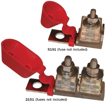

                There we go that one makes more sense to me, i like keeping the inverter wired straight to the batteries, as you can use any old fuse block then.
                No not a good idea. You want a Dual Battery Fuse Block like this. They are installed directly on the Battery Term post like you see in the drawing.
                Originally posted by UrbanElite
                Yes i do see it. That does sound like a smart device. So I will for sure look at installing one, I would see this on an Motor home where the batteries are connected to the alternator, but how does this work on a trailer?
                You would have to make a cable/connector assembly using Anderson Power Pole connectors.

                  No not a good idea. You want a Dual Battery Fuse Block like this. They are installed directly on the Battery Term post like you see in the drawing. You would have to make a cable/connector assembly using Anderson Power Pole connectors.
                  No for sure, I like how those work for mounting to the battery terminal and then the inverter would wire to that. This way if something did happen you wouldn't loose any wire or your inverter. Im talking about using a smaller fuse board to separate my outside, inside and other little gadgets from each other and having them fused. like this: https://www.autoelectricsupplies.co....0134_large.jpg
