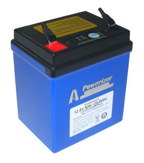

                            Is there any LFP battery that would allow a controller to remain at some small current above zero at CV? From what I've learned here, I would say no.
                            OK then you have not learned a thing or listened over the week. Any drop in replacement LFP battery will do it. Again the issue is your battery disconnecting when charged. A drop in replacement does not do that. They work just like any Pb battery. This one here is 12 volt 4.5 AH lithium battery made for alarm panels that use a Float Charger. You can even buy them for a car battery. It wil float at 13 to 14.6 volts and does not take any special charge or solar ccharge controller. Note it looks like any AGM battery with just one set of terminals. No separate charge and discharge port. There are hundreds of them for sale, all you gotta do is look.
                            Here is another one in your size.
                            Here is a hint: Look for 12 volt Lithium Alarm panel and motor cycle batteries.

                              #149
                              OK then you have not learned a thing or listened over the week. Any drop in replacement LFP battery will do it. Again the issue is your battery disconnecting when charged. A drop in replacement does not do that. They work just like any Pb battery. This one here is 12 volt 4.5 AH lithium battery made for alarm panels that use a Float Charger. You can even buy them for a car battery. It will never disconnect itself from the charger under any circumstances . Note it looks like any AGM battery with just one set of terminals. No separate charge and discharge port. There are hundreds of them for sale, all you gotta do is look.
                              If that battery allows a controller to stay above 0A at CV, then it would keep the GV-5 from going to panel voltage. I'll take another look. Thanks. I hope there are very detailed specs.
                                #150
                                The battery just needs to stay connected PERIOD. That is what you do not understand. A solar panel and charge controllers are current sources. It requires the battery to turn it into a VOLTAGE SOURCE so the Controller can regulate the voltage. You have been given all your options. Pick one.
                                1. If it were me I would just connect the radio to the GGV5 Load Port, or Battery Discharge Port, turn it on, leave it on, walk away and call it good. It will work just fine.
                                2. Get a battery that is compatible and does not disconnect itself from the controller.
                                Take your pick. It is not that difficult. The resistor idea may or may not work but comes with a catch. It uses precious power you cannot afford. A 12 volt 4.5 AH battery only has 54 watt hours with only 44 usable. If that resistor burns 1 watt, you are using 50% of the capacity of the battery in a day making useless heat. That is on top of what the radio uses. A recipe for a dead battery.
