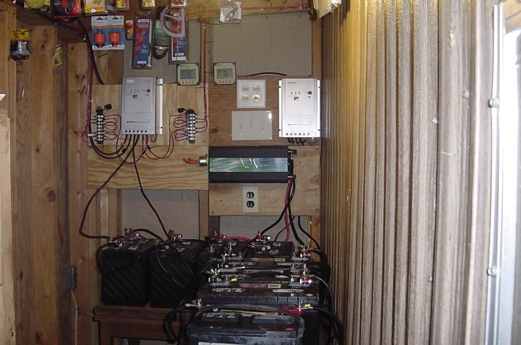

              I have two of the Tracer controllers and I have had no problems with them.
              I have seen them as high as 14.7 when I'm not using anything and it's a bright sunny day
              But soon as the sun goes down I show about 12.8
              I have been using them for about 3 years
                • 15186
                I don't see any overcurrent protection between the Tracers and batteries or batteries and inverter. Looks a little dangerous to me.

                  Are you running the two Tracers in parallel?
