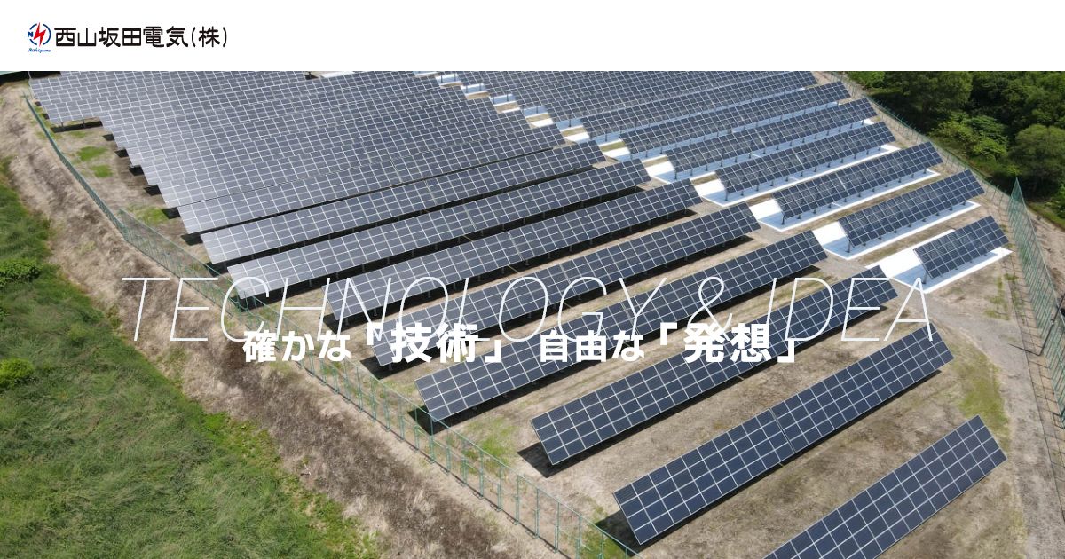

                  Hello. I believe this thread is about the LG NeON 2 panels, which have a reflective backsheet and hence don't qualify as "traditional bifacial panels". In the case of these panels, the bifacial boost can be accounted for in the STC itself, hence eliminating any dependence on environmental features. The panels clearly give a 20W gain over the previous generation (MonoX NeON), however, only after knowing the price difference between the two gens can one identify whether the boost is worth the extra money (hence my question in the previous post).
                  But to answer your question, the only existing bifacial power plant in Japan released its 2014 data publicly early this year. Its reports suggest clear output gains from 18% (summers) to 48% (winters - snow). This data is highly convincing in the case of bifacial modules, I believe.
                  Here you go: http://www.nishiyama-s-denki.co.jp/ (Tip: Google Translate can help you get through the website, but not the PDFs).
                  Another article you may find interesting: http://www.pv-tech.org/guest_blog/bi...kwh_cost_reduc
                    Google Translate had a little trouble with that site, but I gather from
                    旭川市,総合設備エンジニアリング企業,外構工事,内線工事,受変電設備,消防設備,電気設備,照明設備,建築物設備,エネルギー管理,施工実績,電気工事,工事費用,保守点検,設備の設計・施工・メンテナンス
                    that it was a ground mount system in a very snowy area -- precisely the
                    sort of installation one would expect to benefit from bifacial.
                    Do you know what brand and model of panel they used?
                    Thanks for the data!
                    - Dan
                      - Dan
                      Hello Dan. You're welcome. I'd like to ask you to try and focus on the positives, i.e., even in the peak summers, the plant got 18% higher power output from the rear. If that's real, I think bifacials are paying off. The panels used were from a company called PVG Solar, one of the only bifacial manufacturers on the map right now.
                      And as for the snowy areas, yes, I'd say they make a freaking amazing product for such places. Coz in heavy snow, the whole plant goes bust due to snow on the top of the panel, and this is when the rear still keeps producing. And in winters, demands go high in such places, so I think these panels will make a good case.
                      -Drashya

                        Perhaps during winter months it could increase the production but
                        What about shadows on the back from racking.
                        How was the panel tested?

                                Hello Naptown. Well, there are shadows from the racking and from the arrays behind and ahead as well. But, the trick maybe to identify the optimum distance between the two parallel arrays to allow maximum light to hit the ground while also not wasting too much ground surface. However, various field tests done by the companies and labs involved in the technology, show that inspite of the shadow problems the bifacial module still delivers high gains. The data from the Japanese plant, show 18-25% boost in the summer months. When there is no snow. So while the shadow problem does affect the rear surface's potential, there's still a lot that can be gained from it. Nonetheless, a recent thesis sponsored by KTH, Sweden and EDF, France focuses on this exact problem. I haven't been able to finish reading through their procedure and outcome yet, but you can easily find it online and read it.
                                As for the panel testing, I still don't know how the people at the Asahikawa plant were able to tell the difference between their front and rear output, but I don't think it should be very difficult. Generally there are trackers and sensors that can be mounted with the panels, which in my opinion should have little extra cost compared to all the electronic equipment you'd add anyways to the plant (inverters, MPPTs etc etc).
