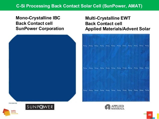

                      #40
                      Interesting video. I was impressed with the ability that it can run that long and that far using the solar cells to keep the battery charged but I have some questions on what I saw and what was presented in the details at the end.
                      The prop on the plane was a folding type yet the details showed a fix type. Also I am not convince the motor shown on the working model was the same as shown at the end of the video.
                      The plane was pretty skinny and clean yet somehow they installed a 3000mAh 4S battery, 20A ESC, video camera transmitter, gps, antenna, etc. I have a few friends that have FPV type planes and they have a lot of "gingerbread" hanging on it.
                      The solar cells were "blank" (without any grid to collect the electrons) so I am not sure how they worked.
                      So I am not sure exactly what was used for the FPV video run.
                      If it is a hoax it is a pretty elaborate one, they have gone to a lot of trouble.
                      I think you will get a view of the battery here https://youtu.be/KHV-RjvTb1c?t=48
                      As for the cells
                      There is some technical information on these here, http://pveducation.org/pvcdrom/manuf...g/rear-contact
                      Simon

                        I stand corrected.
                        That video shows the battery hanging from the bottom near the front. I also saw the FPV antenna hanging below on the left wing tip. So it is possible they built that RC wing to fly FPV.
                        Also I was not familiar with the rear contact solar cells. They also look to be a possible product used on that wing.
                        So I will hang my head and agree that the video is not a hoax as I first stated.
