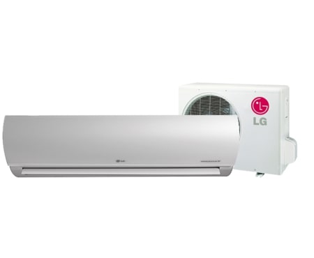

                              The Koolsola air conditioner sales pitch attempts to describe a process, by which their solar panel helps, but fails, dismally.
                              In order to make their product perform better, they claim that a conventional efficiency is EER 2.38
                              The LG K09 models reach EER 5.4, probably when they are going slowly, and outputting only 300W. At this level, you could air condition a coffin, very well.
                              Discover LG K09AWN-11. Click for pictures, reviews, and tech specs for the LG Inverter ArtCool Stylish - Reverse Cycle, Heating and Cooling, 2.50kW.
