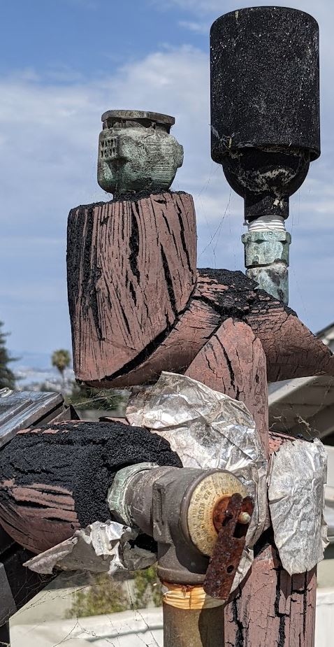

    What could I replace a rusted rooftop TPRV with?
    The valve I have is a regular water heater TPR about 40 years old, that no longer reliably closes

      The big box TPRV's have a steel center shaft. That's what rusted in the above photo.
      I need something with a stainless steel center shaft, rated for outdoor exposure per the photo.

              This system is NOT in a hard water area, so the first thing to go was the shaft rust. Our water does not do much of anything to metal.

                  I found a model with a brass center shaft, and have just replaced it.
                  The check valves operate fine (they are soldered in, so not easy to "remove").

                      But the new TPR failed today.
                      It was a hot day, the controller shut due to overtemp (as it should),
                      the TPR activated after the array reached 150F or so (as it should),
                      but it never really closed again, even after cooler water was pumped to the roof.

                        Do you have an expansion tank on the loop and have you confirmed that the bladder is intact and set to the correct pressure? If the tank is not working, and the fluid expands on a hot day, glycol is going to find a place to leak and the TPR may be the weak point.

                          On the pressure/temp. relief valve, technically, it reads to me like it didn't fail. It prevented an upset condition from getting worse. That is its job.
                          That it didn't re-seat properly is a common occurrence with cheap relief valves. Also, as Peakbagger writes, without an expansion tank, system pressures from thermal expansion can cause a relief valve to lift. All ASME pressure and temp. relief valves require a means to test for continuing operation. Cheap domestic valves meet that criterion with a test lever. A great idea but most experienced plumbers and service technicians I know will never use it to test a relief valve. Reason ? Once the lever is activated, there's a good chance the valve will leak. Now the test lever opens the valve just like an overpressure or overtemp. event does.

                            The most widely used TPRV's are rated 210 degrees F and 150 PSI if it's releasing you have another problem. Most likely the expansion tank / steamback bladder is defective allowing the pressure to exceed 150PSI that's why it wouldn't reseat.
