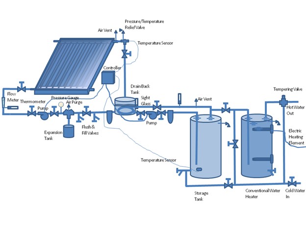

I have a drainback system with the tanks about 20 ft below the flat panel collector. I am wondering if I need an air vent at or near the top HW outlet pipe and if so what kind so that it automatically discharges air when refilling. It will have to be outside at the top of the system, or inside about 12" lower.
Air vent
As long as you maintain an airspace in your drain back tank, size it correctly , and slope your supply and return lines back towards the tank no vents are required. -
I like that answer. Minimizes complexity and heat loss, even though there is one shown in this diagrm: https://www.energy.gov/sites/default...n%20Back_0.jpg

Now my drain back tank shown in the photo has an overflow tube and no air vent connection at the top surface as sketched in the attached diagram from SolarHot USA. I bought the system (barely) used so am trying to piece this together. Maybe I don't need an air vent, despite.
I don't know why the schematic shows the drain back connection from the HW In to panel collector since it is not at the lowest point.
