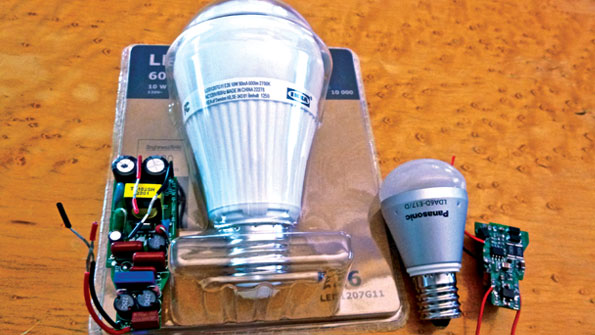

      Third - here is the simple explanation on driving LEDs
      Learn some basics about how LEDs work, how their manufacturers characterize them, and how circuits that drive and/or control them are designed.
      Driving Single LEDs
      It seems as if driving LEDs ought to be simple. They’re diodes, they have a certain forward voltage drop, and their light output depends on current, for which there is a do-not-exceed value for any given diode. That seems like a manageable set of parameters, doesn’t it? But then it starts getting complicated. As with conventional diodes, LED current varies exponentially with the voltage, i.e., a small change in voltage can cause a large change in current. That’s why, in most cases, LEDs are driven with constant-current sources.
      Power sources
      The current–voltage characteristic of an LED is similar to other diodes, in that the current is dependent exponentially on the voltage (see Shockley diode equation). This means that a small change in voltage can cause a large change in current. If the applied voltage exceeds the LED's forward voltage drop by a small amount, the current rating may be exceeded by a large amount, potentially damaging or destroying the LED. The typical solution is to use constant-current power supplies to keep the current below the LED's maximum current rating. Since most common power sources (batteries, mains) are constant-voltage sources, most LED fixtures must include a power converter, at least a current-limiting resistor. However, the high resistance of 3 V coin cells combined with the high differential resistance of nitride-based LEDs makes it possible to power such an LED from such a coin cell without an external resistor.[126]
      (I added the bold)
      And for a real life example of how Current is the factor for LED's, take any simple LED that does not have internal resistors, and connect it to a high current voltage source, and set the voltage for the max LED voltage.
      Use lead acid cells, large NiMh cells, something that will not allow voltage sag when the LED is connected.
      Try it first with an incandescent light bulb, on a 12V car battery. A 12v brake light just lights up.
      Voltage, with unlimited current.
      Now with an LED, you will, when the circuit is powered up, see a brief flash of light as the LED vaporizes itself, as it wants to suck every amp from the batteries it can. A forward conducting diode has very little resistance and requires current control to prevent burning out.
