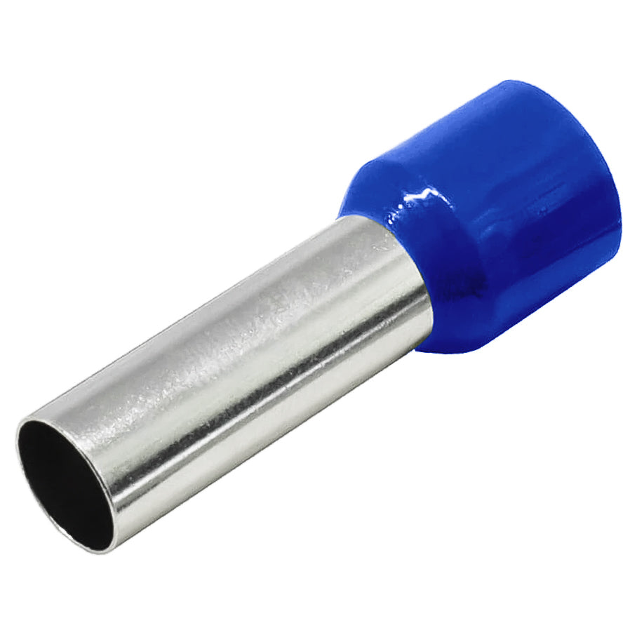

            Or, you may find a wire Ferrule may reduce the gauge of a stranded wire to a size that will fit in the terminal set screw ( going from #2 aluminum to #4 copper )
            https://www.ferrulesdirect.com/colle...-wire-ferrules
            https://www.americanelectrical.com/c...wire-ferrules/
            All have to be rated to handle the aluminum parts.
