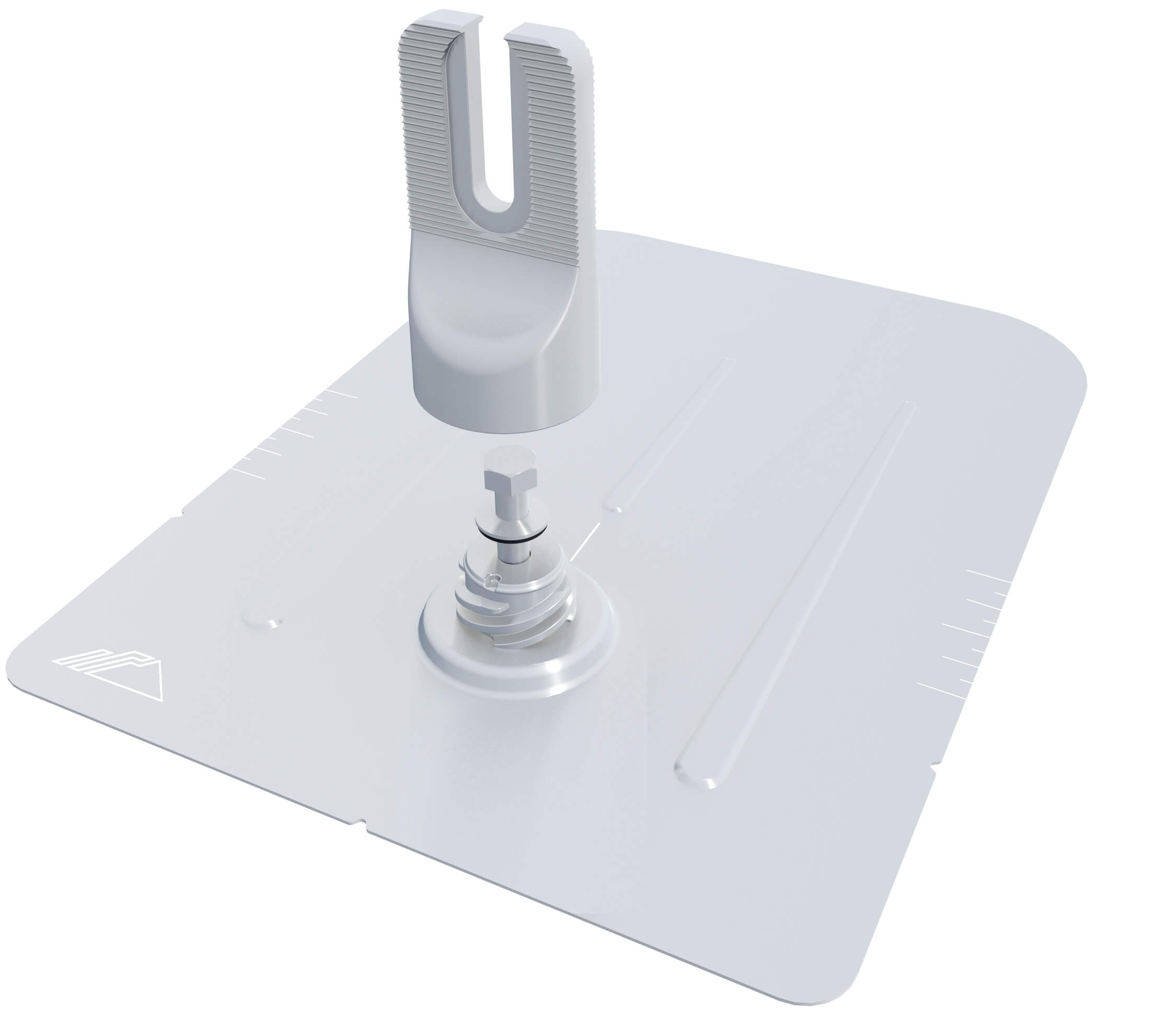

I would HIGHLY suggest that you use the IronRidge flashing system and not get some flashing from Homedepot.
https://www.ironridge.com/pitched-ro...ng-flashfoot2/
Edit: I have concrete tile, it looks like that system is for shingled roofs. I will be mounting it with the angled brackets that fit under the tiles (Ironridge All Tile Hook). The flashing was for electrical conduit connections only.Last edited by nsgoldberg; 06-28-2019, 06:59 PM.Leave a comment:
