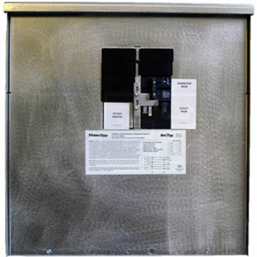

                  Given how small the generator is, and how few the loads. Heavy duty (8-gauge as I have fairly long runs) extension cords seem like the best solution (which is what I'm currently doing). But, with a larger portable generator (6kW to 10kW) and a professionally installed manual transfer switch like this one (see below) you can certainly be code compliant.
                  30 Amp 240VAC input
                  Buy Generac 6382 Direct. Check the Generac 6382 - 200-Amp Outdoor Power Center (30-Amp Generator) ratings before checking out.
                  50 Amp 240VAC input
                  Buy Generac 6335 Direct. Check the Generac 6335 - 200-Amp Outdoor Power Center (50-Amp Generator) ratings before checking out.
                  The main issue from my perspective is phase balancing across the two split phase legs in you load center. Smaller portable gennies don't tolerate the two windings (one per split phase when running in 240V mode) being out of balance by more than ~30% or so. The governor will try and modulate the engine RPM to maintain the proper voltage and one of the windings will either be too high or two low.
                  My portable is 6500kW and I would love to not have to use the hundreds of feet of extension cord I use to temporarily power loads all over my house. But, at only ~24 to 27 amps continuous per phase, it's not really big enough to run my load center (obviously AC is turned off, etc.) without careful monitoring of the phase loading. Using extension cords, and by switching to 120V output, both windings are wired in parallel so no concern over phases. BUT, I cannot power the load center in this configuration -- hence extension cords.
                  A stationary 1800rpm natural gas gennie would be great, but at ~$10-20K installed, a bit to rich for me at present. Perhaps when my cryptocurrencies continue to appreciate further. (-:
