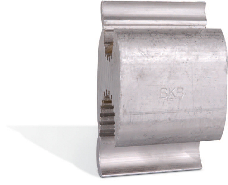

I have calculated that I would need 4 gauge wire between my (future) solar panel and a charge controller to account for a long distance. But when I look at various charge controllers, the terminals look like they would accept maybe 10 gauge or 8 gauge wire, but I can't see how 4 gauge would possibly fit. How would you make the connection to the controller with such large cables coming from a solar panel far away?

With "H" of "C" taps using a hydraulic compression tool. You do have the $2000 tool right.

Although I don't have this tool (nor will I likely be buying one), does it somehow put a connector on the end of a #4 wire that would fit in the smaller opening of a charge controller?
Look at the "H" TAPS. One side for a large wire, the other a smaller wire. That is how it is done.They wil run you about $20 for each tap and require tooling. The taps are solid plated copper and require a lot of pressure to compress.
Or they also make reducerrs you comprees on the end of the wire, but very bulking and clumsy.

You can install a fitting that will allow you to have one side big enough for a #4 Awg wire yet be small enough on the other side to fit a terminal connection for say a #8 awg wire.
The problem is getting enough pressure from a clamping tool to properly mold it around the #4 wire. Using a cheap tool will not get you what you want and the fitting could fail due to high resistance between the wire and it.
Maybe you can rent the hydraulic compression tool.Comment
Split bolt connectors are OK to transition from the #4 to something smaller, as well, no compression tool needed.

Thanks - I see now. But doesn't reducing down to (for example) a #8 wire now introduce a portion of the cable with higher resistance than the #4 wire? Would that present a safety issue if the current on the #4 wire is close to its rated ampacity, but higher than the #8 section now attached to it?Comment
You selected #4 to help with voltage drop over long length. A very short length of #8 won't have enough resistance to affect voltage, and has plenty of ampacity (40 A at the termination) to carry the current. Do you need it to carry more than 40 A?Thanks - I see now. But doesn't reducing down to (for example) a #8 wire now introduce a portion of the cable with higher resistance than the #4 wire? Would that present a safety issue if the current on the #4 wire is close to its rated ampacity, but higher than the #8 section now attached to it?CS6P-260P/SE3000 - http://tiny.cc/ed5ozxComment
Split bolt connectors are the preferred solution here. Cheap, compact, just a couple wrenches needed
