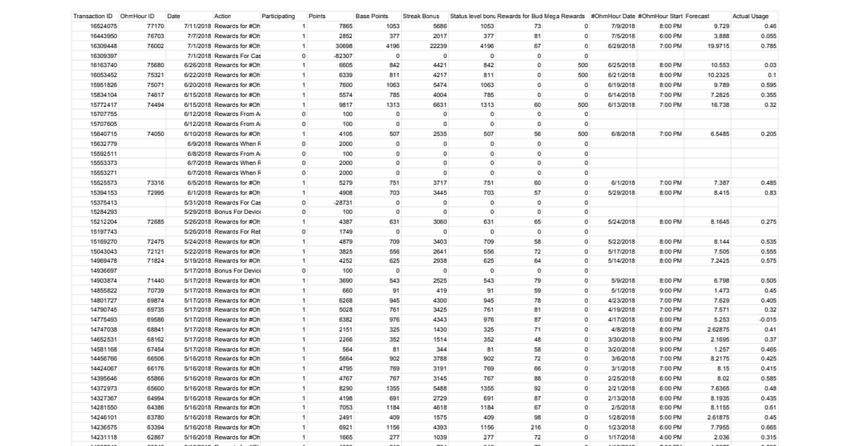

                          UKiwiS - Can you share a spreadsheet of your downloaded point history - Well, wipe out your actual point history, what I'm interested in is the dates and time windows that OhmConnect is asking for. That way I get a somewhat good idea of the time frames that I should expect? For example, should I be expecting a request just before 3am, when my whole house fan is running?
                          • UkiwiS
                            • Feb 2015
                            • 83
                            Most OhmHours are either 7-8 pm or 8-9 pm. Nine of the last 10 are in those slots. A year ago it was different and earlier and I think the shift is due to the peak time shift. Bear in mind that different locations possibly have different times too. Here's my CSV file as of this morning...
