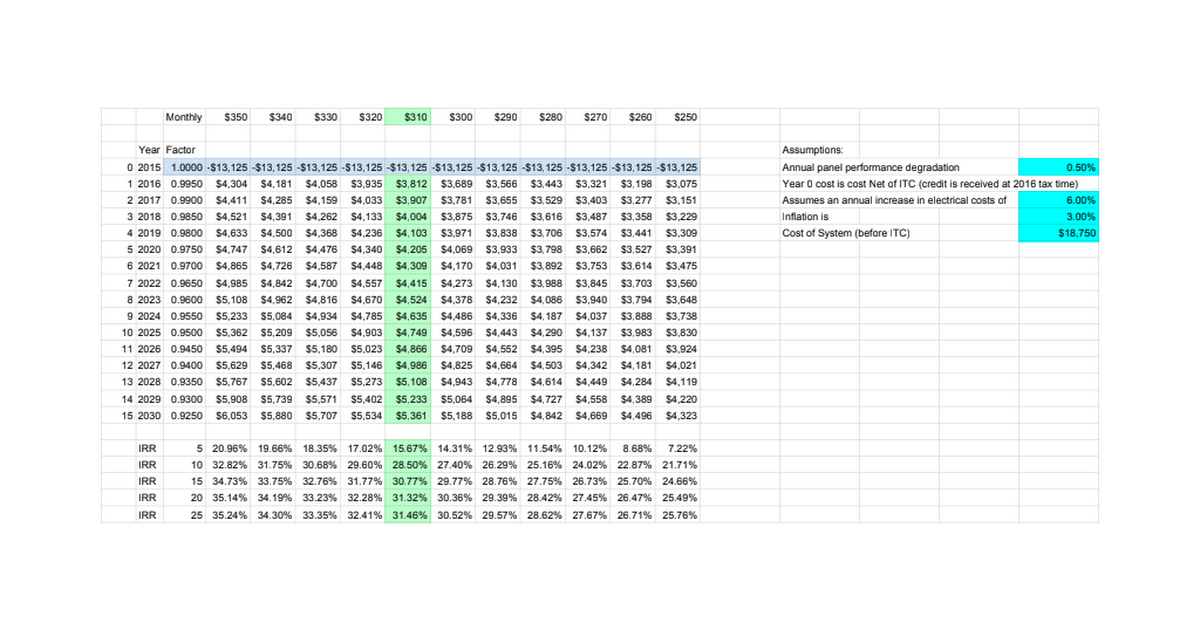

                    I created this to calculate the IRR for my system.
                    I'm not an accountant and perhaps it's flawed but feel free to copy and play with it or edit it.
                    My bill was approx $200 per month so the green column is what I used.
                    https://goo.gl/zGy9dB
                    [url]http://tiny.cc/m8ex0x[/url]
                    • huge
                      huge commented
                      Editing a comment
                      Impressive
