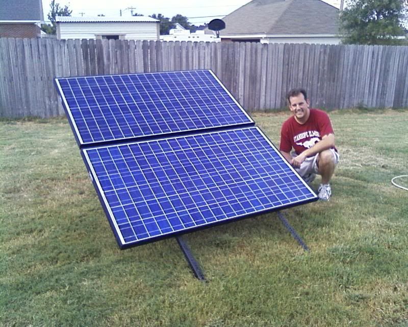

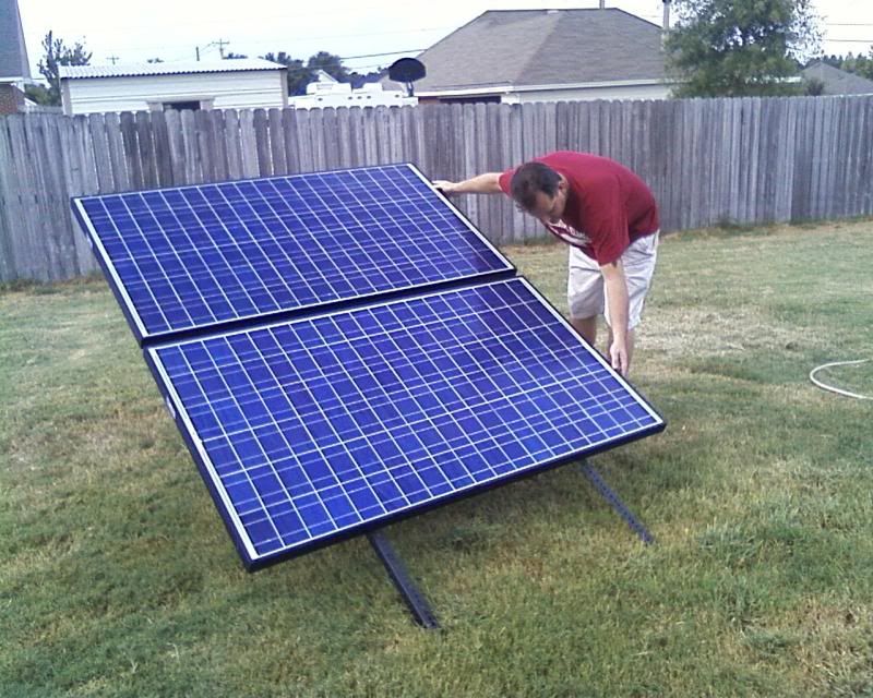

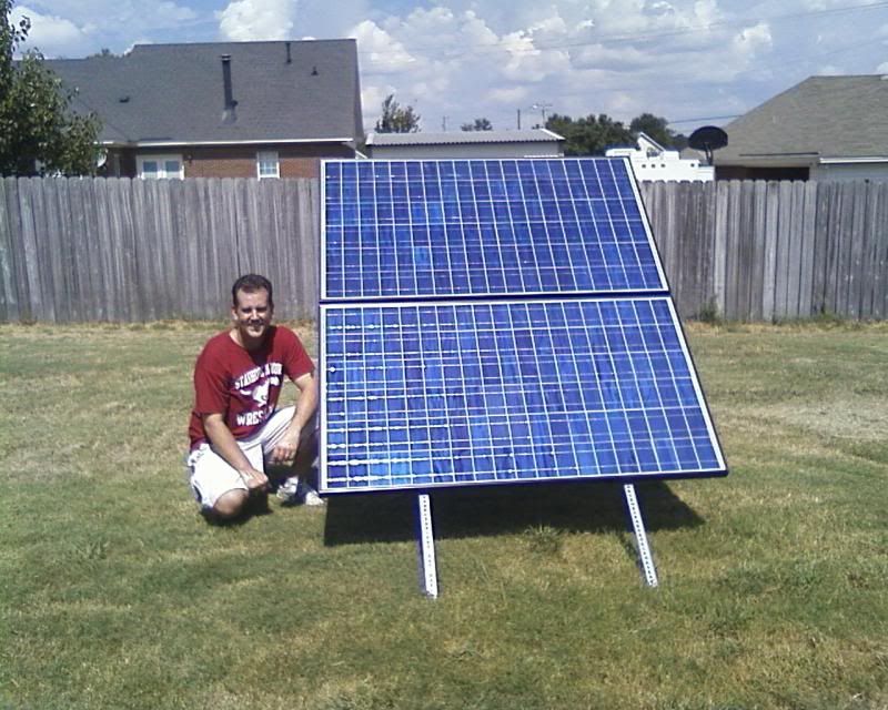

    Here are 2 B grade Evergreen panels that I recently picked up. I ended up building a frame for them out of angle iron. After putting it together I was told that I should paint the angle iron, so I took it all apart painted it and put it back together again. The panels were reading 41 Volts in series today via the volt meter. Is this good for Evergreen Panels? I also had to level them out for my latitude. Here are a few pics.
    The panels should have a sticker on the backside, which will tell you the Voc (voltage open circuit) and Isc (amps short circuit) Those are the 2 ways you can test at home.
