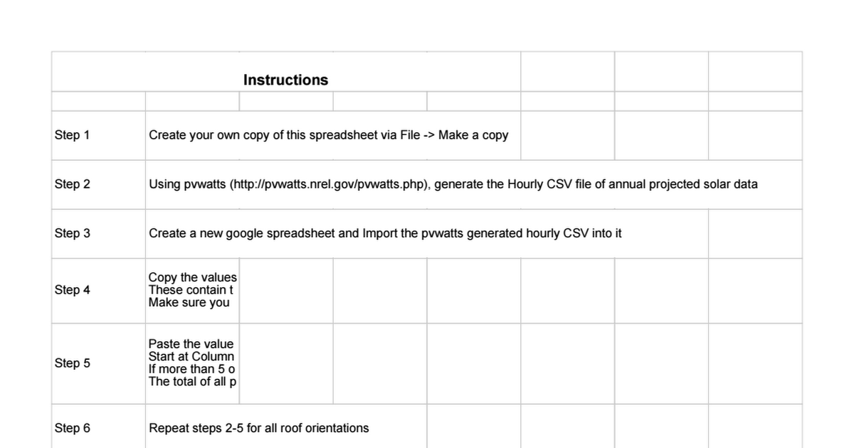

                Ok, I'm going with 22 Sunpower E-327 panels with SolarEdge P400 optimizers for a 7.194kw system. They are estimating 9100kwh annually from this. Does that seem reasonable? How can I model/predict this to confirm based on the specifics of my location, roof, etc....?
                And, they have me specced for a SolarEdge SE6000A inverter, which has a max input of 6000 watts. Given my system is a 7.2kw system, am I being set up for clipping? My roof is on two planes (see photos above), so at no point in the day will all 22 panels be at full capacity at the same time, so maybe a 6000 watt max input inverter is fine?
                Sunpower E-327 + SolarEdge P400 optimizers + SolarEdge SE6000A at $3.90/watt. Washington, DC. Good?

                  7194 / 6000 = 1.20, which suggests a very small amount a clipping in a south facing array, maybe on the order of 1% of annual production or less. On more than one roof, you might get a decent idea of how much is clipping by running PVWatts for each orientation, then adding the hourly output values. For example, if 11 panels face south and 11 panels face west, run PVWatts for each orientation with a 3.597 kW array, and then add the hourly output together. Correct for clipping by including another column that looks for any values over 6000 W AC in the summed output and sets those values to 6000 W. Check the difference in annual output between the corrected and uncorrected columns... it will probably be a small number.
                  When running PVWatts, selecting "Premium", "Roof mount", and 8% loss should be a decent starting point. Your shade will affect the totals a bit, so don't read too much into that, but the model of midday power (when you are most likely to clip) should be better since you will hopefully be shade free.

                    Thanks much. I did this as precisely as possible, and indeed, out of the entire year there are a whopping 4 hours where I will exceed the 6kw AC output max of the SE6000 with the max of 6.18kw.
                    Raw data here, with separate tabs for analysis by day, month, and hour of day.
                    Questions on pvwatts usage:
                    1. Does it just randomly assign shady days based on historical weather?
                    2. Please explain DC to AC ratio parameter. I entered 1.35 due to the 8100w Max DC Power (STC) to 6000w AC output max, but that resulted in pvwatts capping the calculated AC output at 5333.33w many hours. Putting the ratio back to the default of 1.1 and my max AC output values were not capped. So, not sure I understand this parameter .
                    Thanks again.
                      It looks like you got the idea, and your results sound right.
                      The weather used is based on what is known as a TMY (typical meteorological year). Gory details here, page 1 has a nice overview though.

                      This is actually a way to test clipping loss if your entire array could be simulated at one orientation. For example, if you have a 7000 W of panels and a 6000 W inverter, you would enter 7000/6000 = 1.167. This will limit the AC output to 6000 W, and you can see the energy produced with this constraint. Then, you could enter 1.0 and see how much energy would have been produced with an inverter that could have handled 7000 W. In your example, with a 7194 W array, 7194 / 1.35 = 5329, which is roughly the AC output cap you observed.

                        Got it. Much appreciated. pvwatts is an impressive modeling tool, especially for a site that ends in .gov.
