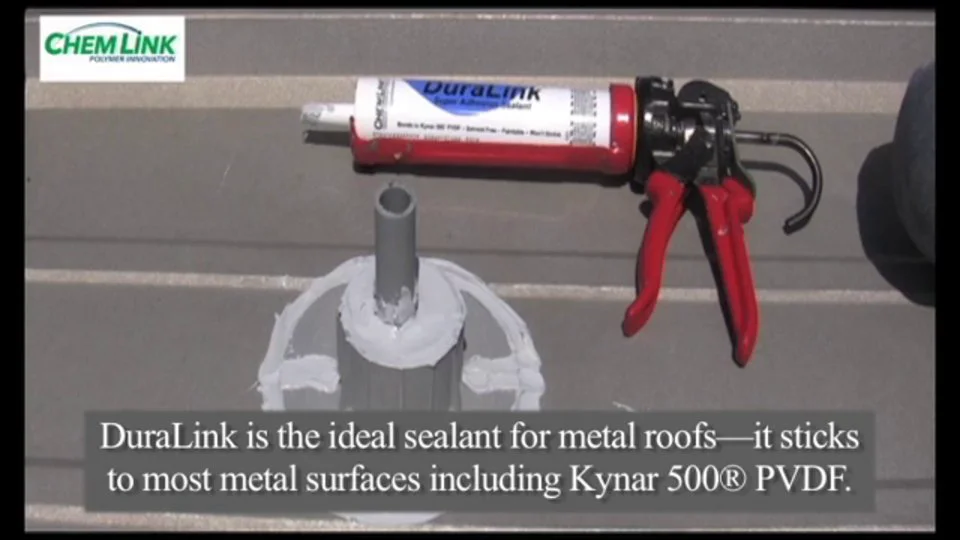

        Please check this product, we use it in the last 5 years with good results .
        Installing E-Curbs on Metal Roofs - ChemLink DuraLink - http://tinyurl.com/lte24j3
