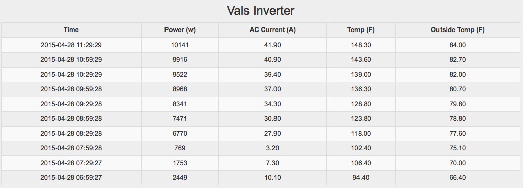

    I was referring to gvl's post about 7746 kW output and the idea that the table you posted has a column headed "Power (kw)". Maybe I'm misinterpreting gvl's meaning, but I took it as pointing out an error, perhaps in a sarcastic way, by pointing to an absurdly large output, and your response that didn't seem to understand the point. But, like I wrote, maybe I'm just missing something and I'm the ignorant one.

        HX_Guy, it's your table heading for power - it should be W not kW. Either that or there's a missing decimal point in the numbers. TBH, I didn't notice this rather minor error initially either as I tend to skim most posts. After all, this wasn't a legal brief or an engineering plan you presented.

            I didn't make the table. But regardless, it's been fixed, the programmer actually noticed that himself yesterday and corrected it.

              So my buddy added an external fan to his SolarEdge inverter and wow, pretty dramatic difference...especially when you take the outdoor temp into consideration.
              Without external fan
              With external fan

                Unless the heat causes the inverter to derate I say buy the extended warranty and don't bother, with fan or not chances are it will fail in the next 10-15 years anyway.

                  I concur - fan is probably about 5 watts - 5W * 24hours * 365 * 10 years = 438kwh. 438kwh = $48 to $144 depending on your price per kwh.
                  Likelyhood of delaying failure by even 1 year? Probably smaller than the 0.16% that would make economic sense. ($48/3000/10)

                      I'm well aware of how electronics are impacted by heat. I've even been involved with accelerated lifetime testing where the item is run while "baking" in a "burn-in oven". I don't recall the exact temps offhand - but they were well above the ~150"F that HXguy is seeing and is concerned about.
                      The thing is that this extra fan is only helping by ~30F *AND* the unit already has a built-in fan that kicks in when the temperature is getting too high (as determined by the manuf).
                      Given those things, I'm doubtful that it makes any meaningful difference in the lifetime of the system.

                        I'm more concerned about the unit derating than anything. I feel my system should be pushing more power during the day, it seems to max out at about 10kW which is the same it was doing a month ago, but maybe that's normal?
                        Either way, I can just put a fan on it temporarily and see what it does before I go looking at a more semi-permanent solutions. I have the stats day by day of the current temps and graphs of the power output, so we'll see if power the temperature by 20º-30ºF does anything, it may not.

                            Why would the fan run when the sun isn't above the horizon ? I've got one that draws 20 W, lowers the heat sink temp. by about 22-25 deg. F. under close to full load. Yearly cost : ~ (8,760/2 hrs./yr.)*(20/1000 kW/hr.)* ($0.176/kW) = $15.42/yr. Some may consider that cheap insurance. Some not.
