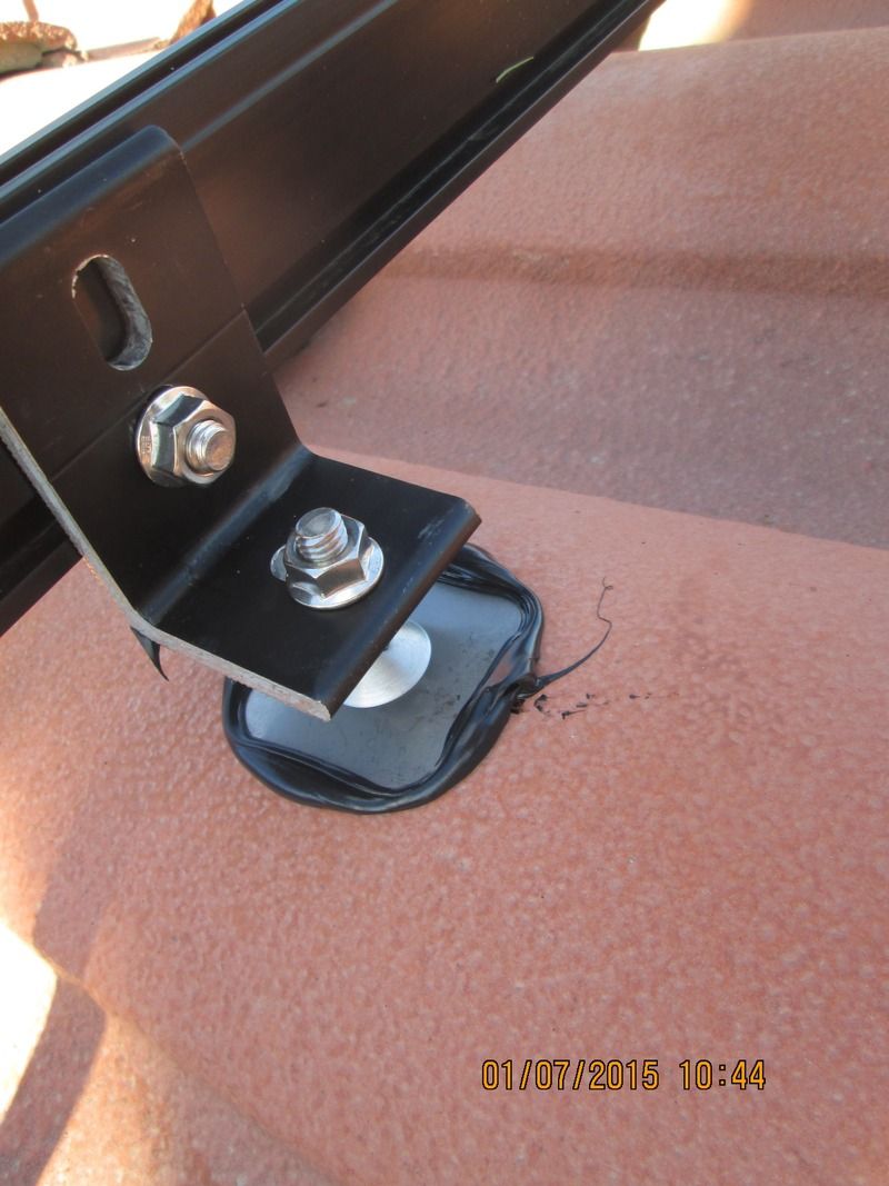

                This is a bit late, but how are the standoffs attached to the roof ? Hope they are not simply drilling through the tiles and caulking the holes.

                  That is what i think they are doing.. Drilling through tile and some sort of black caulking material to seal,
                  I think i have a picture... Would you recommend those S shaped flashings instead? Never too late.

                    here is what is supposed to look like.. it has some sort of a flashing, just not the huge S shaped silver ones I have seen pics of.

                      Are you sure? Maybe it's ok, but certainly a cheap way of doing it. The proper (or better) way to do it is to first remove the tiles and screw the posts onto the rafter, install 1st flushing, cut holes on the tile to allow the posts to come through, re-install tiles, install 2nd flushing and seals. The picture you showed looked like the one done by the infamous installer from AZ, just with better seals. Here is a picture of my installation with the double flushing installed.

                        From my understanding they will remove the tiles, screw posts into rafters, then drill holes on tiles, put them back in, flashing you see and seal. If you guys think this isnt a good method id love to hear what would be better. We dont get much rain but wind can be an issue so obviously I want a good install. Still have a week to go.

                          That picture you showed is a single screw going through the tile to presumably the rafter. If you read the LONG thread from HX_Guy, you will see why it's not a good idea (eg. not stable enough plus a few other reasons). A good installer uses proper mounting posts with 4 screws like the QuickMount system and double flushing that I showed.
                          Edit: from the manufacture http://www.quickmountpv.com/products...unt.html?cur=1

                            It isn't totally clear from the picture, but I think Tile Trac is being used. That is what was called out in the permit. In that system, the bolt going through the L bracket (3/8", that we can see) is not the same as the one going into the rafter (5/6" w/ 2.5 " penetration into the rafter , which is hidden). It is a fine system to use.
                            Edit: Check out the Tile Trac brochure. Installed, it will look just like the picture GMoney! posted. The advantage of this over QuickMount's system is that the L-brackets can be located anywhere along the TileTrac rail, and are not just limited to the rafter locations. They can be more cleanly aligned to the center of a tile, or a splice in a panel mounting rail, or whatever dictates the best position.

                              Yeah, I'm sure it's perfectly code compliant. But so was bolt directly to the rafter. If given the choice and at the same price, I'd pick the QuickMount type of post mount any day. It just seems flimsy to support the array on bolts. Plus the metal cap/flushing material looks pretty small. Eventually the seal/glue will crack, without proper flushing, I'm not sure how much water will go throw the tile. Most codes are very strict on safety but much less on long term rain/wind performance. It's the responsibility of the home owner to make sure that. It's better to be extra paranoid when it comes to your roof. But that's just my opinion.

                                In situations like this, I tend to favor what has tried/true stood the test of time. For my money, one such method is bolting vertical posts to rafters and double flashing them, while caulking and metal taping each flashing around the posts.
