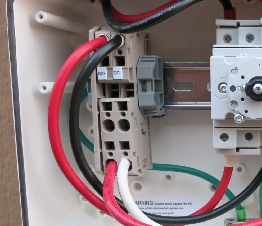

The SolarEdge inverter has terminals for only one string. The inverter's built-in overcurrent protection is sized for two strings, which is why they say they can handle two. If you run two strings, you would still need to parallel them in a combiner ahead of the inverter. Also, by running two strings to the inverter, now you've got 4 current carrying conductors in that FMC, and would need to apply yet another correction factor that has so far been avoided.CS6P-260P/SE3000 - http://tiny.cc/ed5ozxComment
The DC terminals inside the disconnect actually have two sets of inputs, I assume you could come down with two sets of conductors for 2 strings? Like you said though, the conduit fill and temp corrections would need to be changed though.The SolarEdge inverter has terminals for only one string. The inverter's built-in overcurrent protection is sized for two strings, which is why they say they can handle two. If you run two strings, you would still need to parallel them in a combiner ahead of the inverter. Also, by running two strings to the inverter, now you've got 4 current carrying conductors in that FMC, and would need to apply yet another correction factor that has so far been avoided.

Definitely spots for 2 strings on all Solaredge dc disconnects. I don't combine on the roof unless absolutely necessary. Not sure on the conduit fill and temp corrections off hand though.Comment
