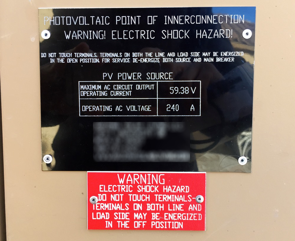

                        Regarding the red label, was that really supposed to say that the PV wires were "underground" or was it supposed to read "ungrounded"?
                          It sure WASN'T! It's supposed to say say "Ungrounded", just like this label should say 59.38A, not V...and 240V...not A. The inspection didn't catch any of it, but maybe I'll get lucky next round! Oh, and "Innerconnection" isn't a word.
