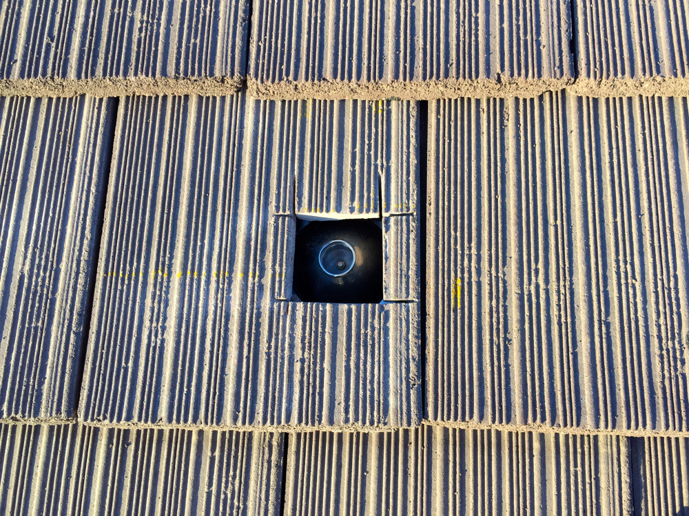

    Why not make the hole smaller and seal around the hole?
    6k LG 300, 16S, 2E, 2W, Solaredge P400s and SE5000
    • HX_Guy
      • 1002
      #227
      For the tile to clear the aluminum cone of the subflashing, the hole has to be pretty big. I tried doing a 2" hole before, as you can see here, but the tile is actually pressing down on the cone area underneath and not sitting flush against the surrounding tiles. The hole has to be about 3" for it to clear properly.
      The installation instructions don't call for sealing up the hole because it's not necessary, you have a piece of top flashing that goes under the next layer of tiles up so really there isn't much way for water to get into the hole...and even if some does get in, you have the underlayment to take care of it.

          I think you are better off with the big holes. If the hole is pressing against the cone or the standoff, it will be putting force on the tile that could eventually crack it with temperature cycling.
          • Ian S
            • 1879
            #230
            I agree. It would be problematic to have the cone in contact with and putting the tile under bending stress in an area (cut) with a propensity for crack initiation and propagation.

              Honestly I th no the bigger problem would be the come creasing and possibly cracking, potentially letting water in. The flashing aluminum is very soft and I did crease a couple just by place a tile down to measure. I see no down side to a slightly bigger hole so definitely going that way.
              • HX_Guy
                • 1002
                #232
                Hallelujah!!!
                Mounts are freaking DONE! Damn that was a lot of back breaking work today...took about 6 hours to cut probably 140 or so holes. Luckily a buddy of mine helped out, he did the measuring and fitting them back into place, I did the cutting.
                Had to break out the big-boy tools today...first time using one of these, cut like a hot knife through butter. That hole-saw was complete garbage, not only did it take forever to make one hole, but then the piece cut out would get stuck in the saw and it was a bitch to get it back out, took me literally 1 hour to do 6 tiles.
                I was thinking about painting the aluminum top flashing but I don't know, they are going to be covered by solar panels and you can barely even see them from ground level as is.
                The rails go on tomorrow!!

                    Thanks Volusiano! Yeah that flat patio cover is really nice to have there for staging, though I did the cuts on the actual roof instead of carrying tiles back and forth (tried that at first and it was too tiring and time consuming). The roof pitch is 18º so not bad to work on.
                    I'm putting the rubber donut on the cone tomorrow, ran out of time and energy today. That should be pretty quick though and then I'm going to attach the L feet. Unfortunately I won't get to finish all the racking as I don't have enough. The original installer was supposed to bring more...but who knows now, I may need to order more myself.
                    And yeah, all he has left to do is put up the panels and I'm probably going to run the wiring myself actually so he doesn't even have to do that.
                    I don't even care about subtracting the labor part out really, he can keep all the $15k in barter dollars he has received as long as he finishes the job. I haven't heard from him in almost two weeks...which was about the time I told him he needs to redo all the mounts, maybe that's why he's not responding. I'm sure he'll be pretty surprised when he hears it's all done.

                        When using a hole saw on tile... you drill straight through.... then at the last little bit, you angle the drill so the bit cuts through from 11 o' clock to 1 o'clock, then back the bit out.
                        Then take a small hammer, and rap on the remaining slug. It will snap the last little bit connecting the slug to the tile.
                        Easy-Peasy....

                          Hah yeah I tried that, twice, both times I cracked the whole tile in two when tapping out the slug. That's when I went to Home Depot and rented the grinder. Even if the hole saw didn't have the problem with the slug getting stuck inside...it was sloooow. Literally like 45 seconds or more to make it through. The grinder was under 10-15 seconds max.
