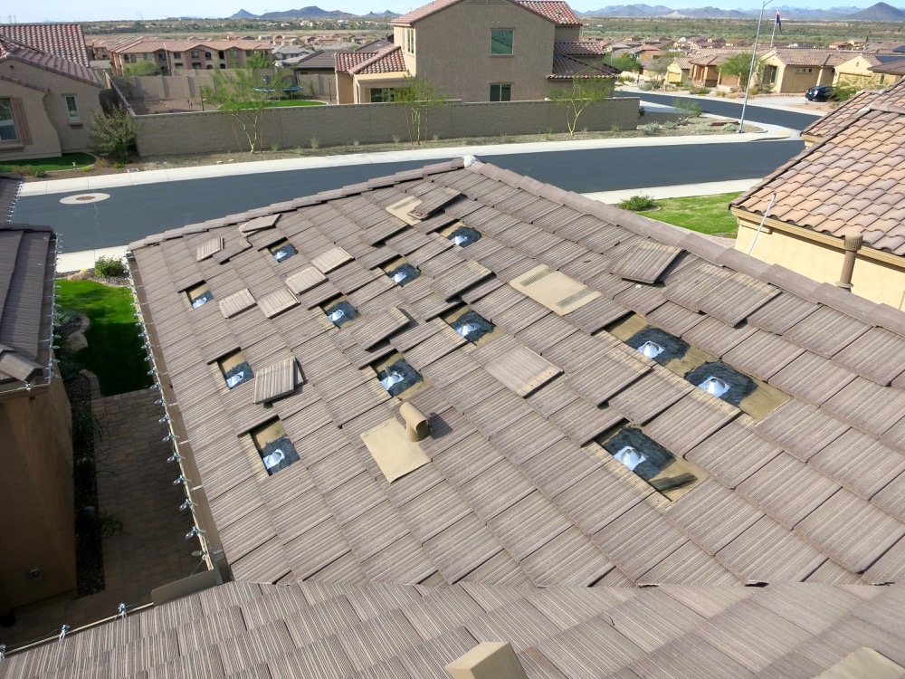

            Originally posted by Ian S
            I thought the underlayment was the primary waterproofing on a tile roof. The tiles do provide some water protection but mainly protection of the underlayment against other elements like sun, wind etc.
            I don't know if "primary" is the right word of "most important". Normally I would think that very little water should make it's way under the tiles anyway which is why I think there is a top flashing on the tiles in additional to the flashing on the underlayment. With the hold in the tile, a whole lot of water would make it's way under the tiles and while the tar paper underlayment wouldn't let it leak through, it's probably best to keep it as dry as possible if you want it to last.
            The finished product will look like this, thought I will probably paint the flashing to match the roof tiles.
            • HX_Guy
              • 1002
              #201
              Put in another 3 or so hours in today, wasn't going to work on it but I got a good 9 hours of sleep and felt motivated.
              Got all the roof cementing and reinforcing fabric done for all 100 standoffs. Next step will be to measure and cut the tiles on Friday and then do a second coat of roof cement before placing the tiles back in place. Should be done with all that on Friday and be able to start with the racking on Saturday. :woot:

                    #204
                    That's an unusual pattern, are there some really long spans with no mounts?
                    • HX_Guy
                      • 1002
                      #205
                      No not really. Most spans are either 48" or 72", I have one that is 96" because I couldn't avoid it due to a vent but that's the only really long span.

                        #206
                        As long as the AHJ is OK with the design I guess it's OK. I assume you're aware that the system was (supposedly) designed to withstand certain wind loads and that you might catch hell if it's not built as-designed, depending on the inspector.
                        • HX_Guy
                          • 1002
                          #207
                          This is the layout that was designed and approved by the city, it's the original layout.
                          The way the installer did it did not follow the design...the layout was generally the same I guess but he had the panels in portrait instead of landscape.
                          Basically he was going to install them like this, even though this isn't the layout we agreed on or approved on the permit. It did use A LOT less racking and mounts though, so of course we know why he did it.

                                #210
                                I assume this is the 96" span?
                                Is it 96" and not 97" or more?
                                What racking are you using? Is 96" span OK in their installation manual?
                                And what is that vent you're spannng? Is that a bathroom vent? Attic vent?
                                Do the plans submitted show a 96" span?
                                Also FWIW, even if the plans do show that span, if it's not up to code the inspector has every right (and obligation) to not sign off.
                                Just because something gets past plan inspection doesn't mean it's OK to do. (but if you point out anything that is questionable, and get their opinion, most likely the same person will keep the same opinion come permit sign-off time)
