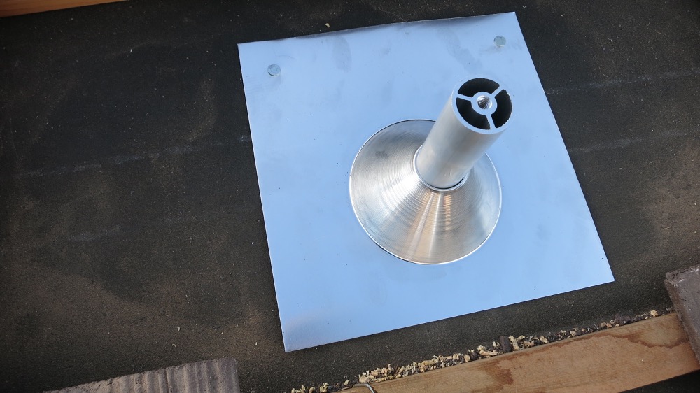

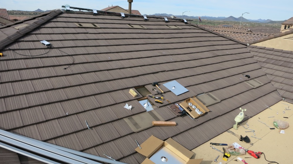

                        I guess I can see why my installer cut every corner he did...this is very time consuming and tiring! Took me 4 hours to do 16 standoff posts (and I still have to cut the holes into the tiles)...oh and plus another 3 hours to undo all the work he did.
                        Oh and the comedy continues...anyone know a good way to find the studs in the roof? How about just drill till you find it??
                        For $9 he could have bought this magnetic stud finder! It works so well I was pretty amazed.

                            Nice pictures and nice work. You won't regret knowing that it will fully meet your standards.
                            Doesn't the stud finder work on the nails driven to hold the wood? If so it isn't any more
                            accurate than those nails. I have been known to drill a small hole where I think the edge
                            of a stud is, to see if I hit it, miss it, or run down its side. With that info I might even drill
                            another (small) hole to narrow it down more. I see some nails in the attic that missed the
                            stud. Bruce Roe

                              I don't see evidence your installer was there. Is he out of view of the camera?
                              This all looks quite a step above his work.
