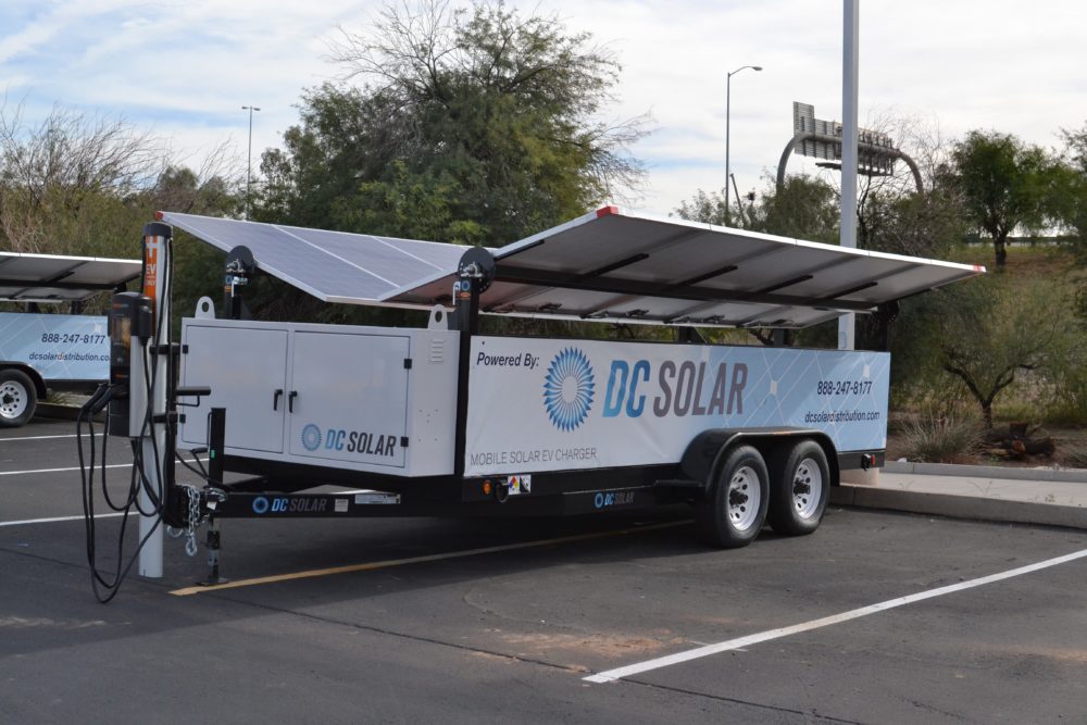

              Brand new.. even came with the 10 year extended warranty which I verified with SMA via the serial numbers.
              They were the result of a company called DC Solar going out of business because the company was a scam. The courts liquidated the company and dumped around 20,000 Sunny Islands onto Ebay.

                  Oops.. extra zero thrown in.
                  Here's the news release on it. The Sunny Islands were on ebay for months selling like hot cakes. GAGlobal auction sold most of their trailers (2 of the SI's on each), then more of the SI's new in boxes.
                  On June 12 & 13, the saga of DC Solar will come to an end in an auction at the company’s headquarters in the San Francisco Bay Area.
                  Surplus product from bankrupt solar company DC Solar, which sold products for the mobile industry (solar powered lights and generators), are now up for
